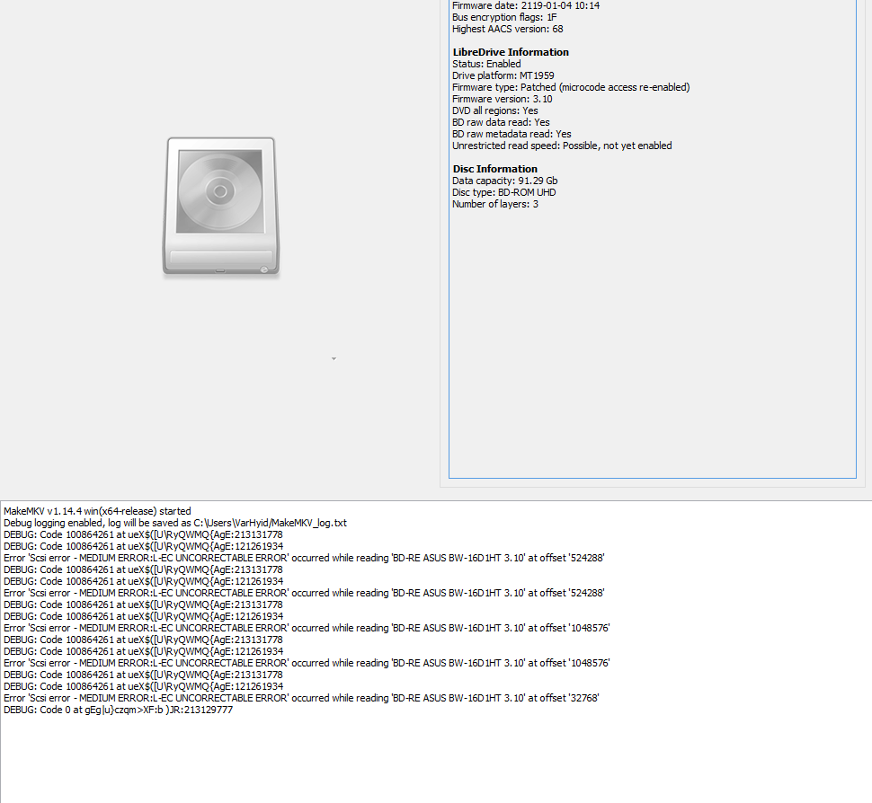

For some reason my drive can't read the 4K disc with "The Hunger Games: Catching Fire" and I wonder if anyone here could help me out or knows why.
It fails right away during the initial process of identifying the disc so I enter the disc, see the spinning animation in MakeMKV and normally once it reads the disc, I click on this icon and then it reads the contents, but with this movie, I can't even click on it because it keeps spinning and fails to even identify the disc.
I'm using MakeMKV v1.14.4 and an ASUS BW-16D1HT drive which initially came with firmware version 3.03, but I downgraded it to 3.02 right-away using the tool provided on this forum. I had no issues with other discs so far.
Here's the log:
MakeMKV v1.14.4 win(x64-release) started
DEBUG: Code 100864261 at ueX$([U\RyQWMQ{AgE:213131778
DEBUG: Code 100864261 at ueX$([U\RyQWMQ{AgE:121261934
Error 'Scsi error - MEDIUM ERROR:L-EC UNCORRECTABLE ERROR' occurred while reading 'BD-RE ASUS BW-16D1HT 3.02' at offset '1048576'

LIBMKV_TRACE: UDF mount: disc not properly formatted(bad VDS)
Before someone says "the disc is scratched" - it's not. It's brand new in pristine condition, not a spec of dust on it, not even the tiniest scratch. Does anyone have a clue why this is happening, or better - how to solve it? BTW, I had no issues ripping the other 3 Hunger Games movies from the same collection.
Is this a standard message you always see when the disc can't be read or is there really something wrong with the formatting? If it's simply just a bad disc (maybe from some bad master?) then of course nothing will help and I'd have to re-buy it anyway. Let me know if you know what this error message means.

VarHD
Posts: 102
Joined: Thu Apr 04, 2019 4:40 pm
Re: Can't rip (or even read) "The Hunger Games: Catching fire"
Post by VarHD »
Indeed, it's on Amazon... at almost 4 times the price of ASUS, that's insane. I guess it's 25 GBP for the drive and 200 GBP for the official UHD licensing ;)
Honestly, I'm not willing to pay that price, at least not yet. I just tried to crossflash the LG NS60 1.0 FW, but that didn't help either. My next step will be to buy a different edition of this disc/movie, it's something I have to try first, it would suck if I'd buy an expensive drive only to find out it's actually a bad disc.
One more question - does the fact that the LG drive seems to read more discs come from it being official and not just "UHD friendly" or is it because LG simply uses different (better?) hardware, different calibration etc.? I'm asking because there are other LG drives on the "friendly" list which are way cheaper so if it's a case of LG drive being better at reading some discs, I'd rather get one of those.
Posts: 2778
Post by SamuriHL »
I would also try to get the disc replaced just to be sure. I think that's absolutely the right thing to do FIRST.
I don't really know the answer to your question, though. My personal belief is that I think it comes down to calibration. Other than the AACS 2.0 hardware support, the LG official drives are using the same mediatek chip as the friendly drives so I can't believe it's hardware. I could very well be wrong. Maybe they use a different laser head or something I don't know. I can tell you that I did a test a few months back and I was able to flash the calibration data from my ASUS drive onto my LG (keeping the LG's encryption data) and it allowed me to write to BD's just fine (a problem some of us had when cross flashing the LG drive with the ASUS firmware to make it friendly). I suspect going the other way would likely work but I don't know if it'd help in reading discs and is a MAJOR pain in the ass to do. And getting it wrong could easily brick the drive. It's not a simple matter of flashing with a WIndows flasher. It's not even as simple as using dosflash and the data mover tool. The firmware has to be manually prepared to keep the encryption data from the current drive with calibration data from another, and THEN flashed using dosflash. It's not something I recommend. That being said, an LG friendly drive like the NS50 or NS55 could be the way to go for those discs. I just don't have any experience with them.
VarHD
Posts: 102
Post by VarHD »
The saga continues. I ordered a new disc on eBay which is an Australian import. Unfortunately, it won't work either, but, it behaves a bit differently.
Sometimes it will generate similar error codes to what I've posted originally, but unlike the previous disc, it will only mention 3 sectors it can't read instead of a dozen. Other times, it won't generate any errors and will kind-of... almost mount, but not really. I mean the spinning disc animation will stop and no longer spin, but instead of letting me click on it to proceed, it's not clickable and on the right side, even though it detects the number of layers and the size (91.29 GB), it doesn't recognize the disc, I mean... doesn't identify it as a movie, just as some data disc:
It's a disc, it has 3 layers, but... no idea what it is?
Ironically, when I re-tried to mount the old disc after the new one, it sometimes also does the "half-mounting" (detects the disc, but not the content).
I'd prefer not to try to do the manual flashing you've mentioned (calibration data without encryption data) so I guess my next step would be to buy an LG drive, preferably a "friendly" one given the significantly lower price.
BTW, I wonder, does anyone reading this have this disc and if so - did you manage to rip it? Is this a known "problematic" disc/movie with some funky special copy protection?
Posts: 2778
Post by SamuriHL »
It's DEFINITELY not a copy protection issue. It IS, however, a triple layer disc which are notoriously a pain in the ass to read for many drives. The ASUS drive, even with the improved MK 3.10 firmware, has issues reading certain triple layer discs. It really is a fantastic drive for most discs, but, occasionally it just refuses. I hope your idea of getting an LG friendly drive works. It's one of the reasons I hedged my bets with the NS60 official drive. I've never had a disc that couldn't be read in either of my drives. I upgraded these on VUDU when they had a sale so I never got the UHD's for them.
VarHD
Posts: 102
Post by VarHD »
I'm not sure how much knowledge you (or anyone reading this) has about the BD manufacturing process, but in case you know a lot about it, do you have any idea why some triple layer discs are problematic?
I'm just asking out of curiosity. Logically, I would think that if a drive has issues with 3-layered discs, it would have an issue with all of them and I would understand that, but I wonder what's the reason why only some of them can't be read? For example, if I had data from, let's say, 10 000 people who have a disc that can't be read by a certain drive that otherwise has no issues reading other discs, would I find a pattern such as - all the problematic discs were made at the same facility or they're all almost at full capacity (for a 3-layer disc) or would I get a rather small list of specific movies indicating that this is linked only to certain releases (maybe from the same studio)?
I just can't wrap my head around what makes some of them "special" and the curiosity kills me ;)
