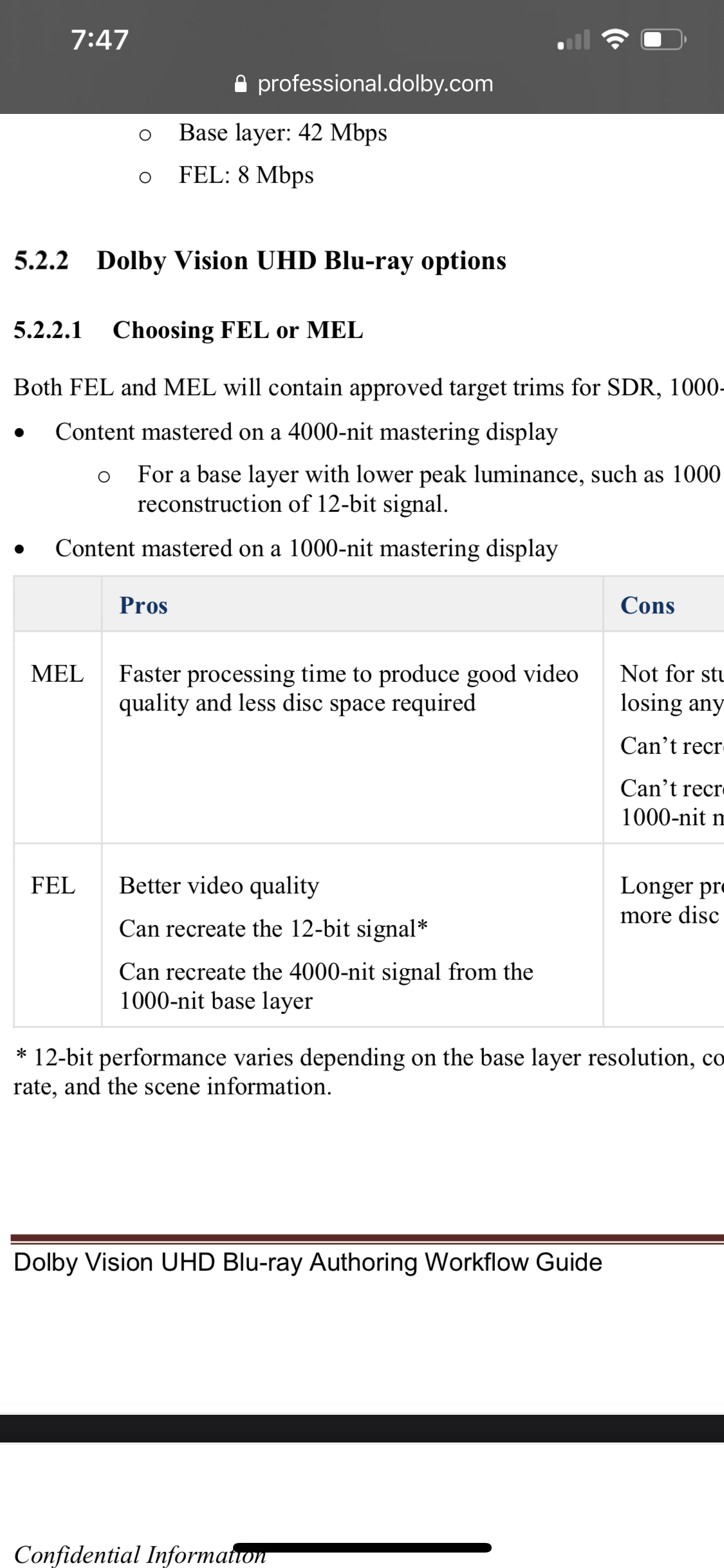

quietvoid wrote:
Mon Dec 21, 2020 5:15 am
420 is not wrong, the patent specs also only mention 12 bit YCbCr 420 reconstructed output.
As for the HDMI transmission, it is detailed as 12 bit YCbCr 422 because the metadata is also transported into the least significant bits.
No where is there a mention that the output video is actually 12 bit 422.

quietvoid wrote:
Tue Dec 22, 2020 10:49 pm
first off, nobody said 420 is "wrong" - that is your wording. 420 simply has less color resolution, hence 422 is more desirable.
Second, both STD and LLDV output a 12bit 422 signal yet only STD contains in addition the dynamic metadata because it's tv-led. so the player-led stream (already DV decoded) which also contains 12bit 422 signal requires less bandwidth, hence it provides low latency...
again, BOTH DV stream types contain 12bit 422 signal (because that's the Dolby spec), yet LLDV has less data than the other... only STD carries metadata in the stream, not LLDV.... hence your 2nd statement is also wrong.
to recap:
all DV streams are 12 bit 422.
only tv-led contains the full dynamic metadata, so full stream requirements, hence RGB tunneling in 8bit float container is used.
player-led requires less bandwidth because it contains less data (still 12 bit 422 signal).
MEL is also 12 bit 422 but only contains a 10bit 420 signal, padded.
and to stress this part:
you make it sound like that "explains" a 12bit 420 final output. no, the metadata allows to reconstruct the full 12bit 422 master, which is why it is a 12bit 422 signal.
if final output was 12bit 420 (so EL only contains luminance, Y difference) for FEL STD, they wouldn't need a 12 bit 422 stream, they'd use a 12bit 420 stream. Metadata is the mere difference, it doesn't need "extra" space on top of the difference, especially since it's encoded as well.

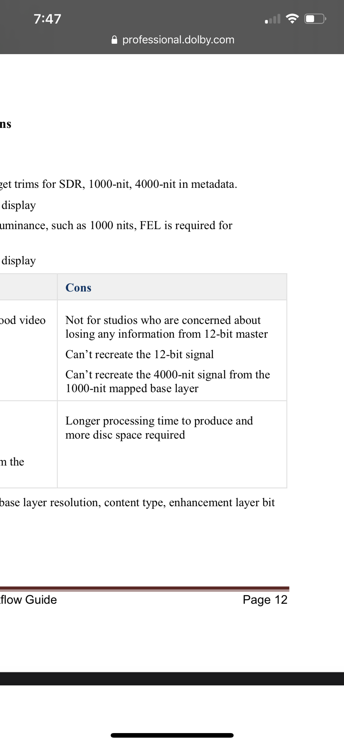

most folks here are forgetting that 12bit 422 ONLY ever comes into play for profile 7 FEL - not even profile 7 MEL (10bit 420).
All the gazillion other DV profiles are all 420 drained sauce for streaming. THIS is easily 90+% of DV content.
Then, for disc releases (--> profile 7), (unfortunately) the majority of releases are MEL... so 12bit 422 (--> p7 FEL) only rarely ever comes into play.
This may be another reason why in the many Dolby docs this is not explicitly stated, to not confuse content creators who in 9/10 cases will use single DV layer BL (for garbage compressed streaming), and even if authoring disc deliverables, then often use MEL.
Even some of the largest disc releases do not get DV or DV FEL (--> SW, only EVIII from Ryan Johnson is DV, but MEL). There are authoring issues with FEL when one gets into the 2nd and 3rd layers on the UHD disc, so that seems to be another huge obstacle.
again: p7 FEL tv-led is as good as it gets right now.
pete19
Posts: 31
Post by pete19 »
and here's more...
there are only two (2) DV streams:
1) 8bit RGB via tunneling (for STD tv-led, as it contains both BL+EL data)
2) 12bit 422 for everything else (LLDV player-led, MEL, or single layer profiles)
IF (!) the actual max chroma subsampling was 420, then the 2nd stream variant above would only need to be 12bit 420 - there would be no need to use 12bit 422 (+ HDCP, hence you'd never use more bandwidth than needed).
MEL is just 10bit 420 anyways, all single layer profiles as well.
IF (!) profile 7 LLDV was 12bit 420 for FEL releases you could just use a 12bit 420 stream as LLDV carries no metadata (DV was already encoded by player).
But they specc'ed a 12bit 422 stream as LLDV for p7 FEL is a 12bit 422 signal.
