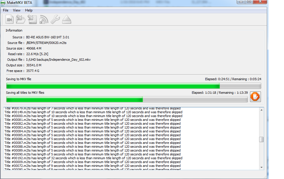

Here is a screenshot of Independence Day UHD not sure if this is working correctly. It is making multiple mkv files 37g-39g its on the 4th one now. This is being done off the disc not from a rip. The button to make the mkv became available so I clicked it.

Sounds like you have multiple playlists selected so it is ripping everything you have selected.
If you are new to MakeMKV I think some of your problems are related to basic usage and aren't specific to UHDs.
I don't have Independence Day so I can't comment on that disc.

I figured it out thanks.preserve wrote:Sounds like you have multiple playlists selected so it is ripping everything you have selected.

I figured out how to insert the keys it was much simpler than I was thinking. I just copied them from various posts on the Doom9 thread on note pad.
I unchecked all the unwanted files and made a movie only backup of the file I wanted. Worked good and processed fast. What I'm missing is how do I retain the full audio. I end up with a 37g backup which may or may not be in 4k with down graded DD 5.1 audio.
