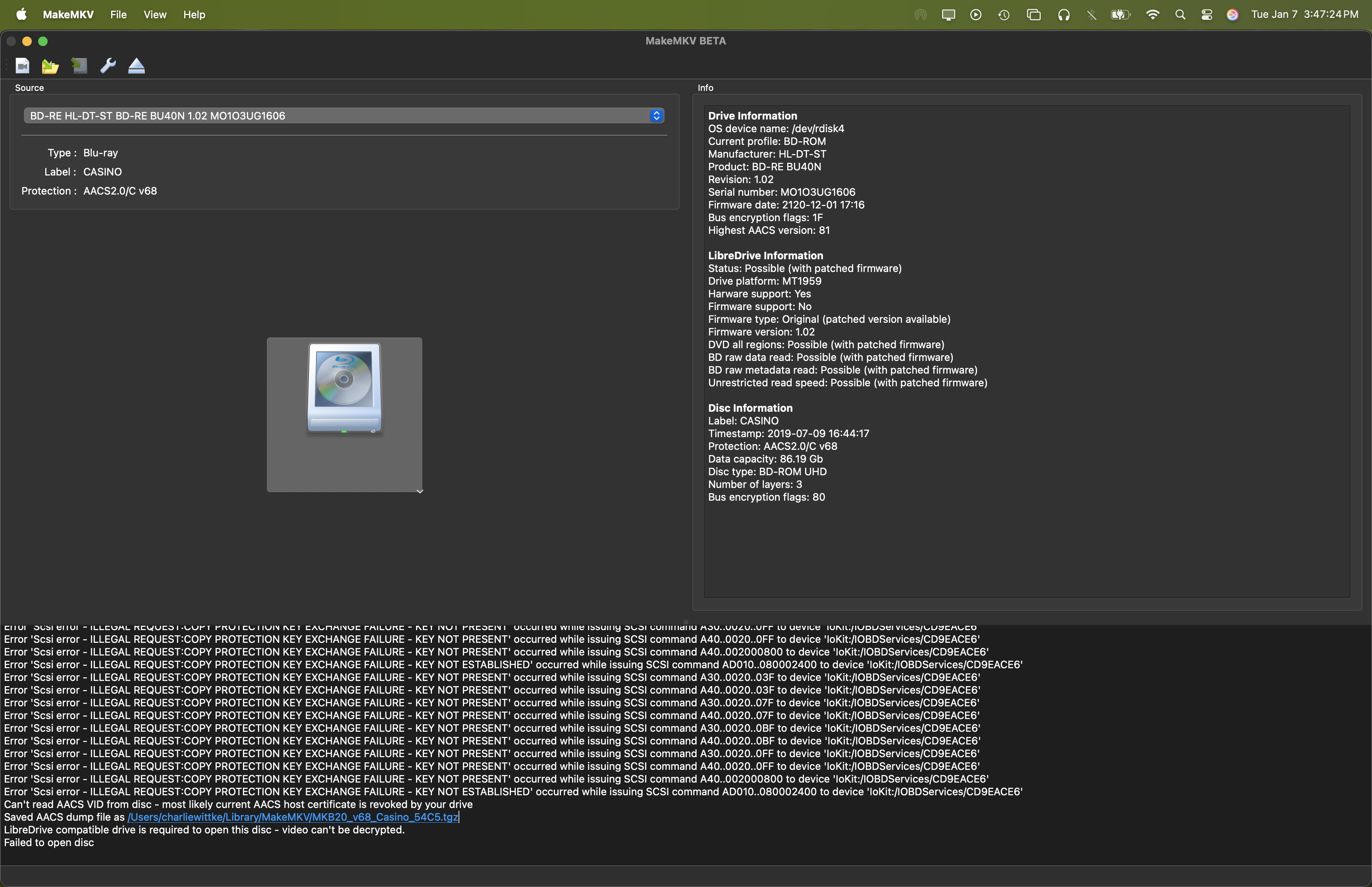

Hi everyone. I just bought an Archgon Premium Aluminum External USB 3.0 UHD 4K Blu-Ray Writer Super Drive for PC and Mac, but attached hereto is a screenshot of this message which appears whenever I attempt to rip a UHD disc. It says, "ILLEGAL REQUEST:COPY PROTECTION KEY EXCHANGE FAILURE - KEY NOT PRESENT". "Can't read AACS VID from disc - most likely current AACS host certificate is revoked by your drive." "LibreDrive compatible drive is required to open this disc - video can't be decrypted." Did I buy the wrong kind of drive? Is it a Mac problem? Do I need to install something? Please help me. Thanks in advance.

You need to flash it to enable UHD reading and libredrive. If you have Windows 10 or 11 64 bit, you can use the SDFTool flasher UI to flash the drive to LG BU40N 1.03-MK then flash it again to BU40N 1.00.chocolatefactory1994 wrote: ↑Tue Jan 07, 2025 11:58 pmHi everyone. I just bought an Archgon Premium Aluminum External USB 3.0 UHD 4K Blu-Ray Writer Super Drive for PC and Mac, but attached hereto is a screenshot of this message which appears whenever I attempt to rip a UHD disc. It says, "ILLEGAL REQUEST:COPY PROTECTION KEY EXCHANGE FAILURE - KEY NOT PRESENT". "Can't read AACS VID from disc - most likely current AACS host certificate is revoked by your drive." "LibreDrive compatible drive is required to open this disc - video can't be decrypted." Did I buy the wrong kind of drive? Is it a Mac problem? Do I need to install something? Please help me. Thanks in advance.
Charlie
Explanation: The first flash removes the encrypted firmware. The second flash puts the drive on BU40N 1.00 firmware which is the most compatible firmware version for Mac/Linux.
If you can't use Windows to flash the drive, you can use the terminal in Mac. See here for the commands: viewtopic.php?p=74718#p74718
