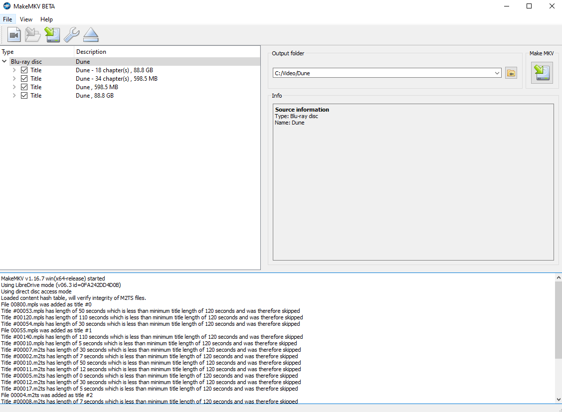

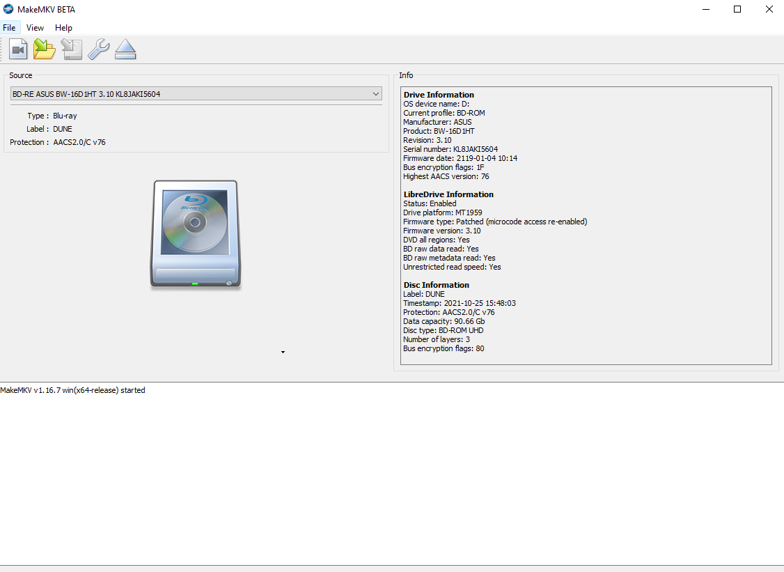

Hi Guys, i had a similar problem with Monster Hunter a while ago.
It just stops ripping after a while...
Any Ideas?
I tried my Drive internally SATA and externally via USB -> same result
Is my drive broken? I ripped like 30 or more UHDs with close to no issues...
Saving 1 titles into directory //ds220/Movies/movies/Dune
Error 'Scsi error - MEDIUM ERROR:L-EC UNCORRECTABLE ERROR' occurred while reading '/BDMV/STREAM/00014.m2ts' at offset '11324160000'
Error 'OS error - STATUS_DEVICE_DATA_ERROR' occurred while reading '\Device\CdRom0' at offset '11324160000'
Failed to save title 0 to file //ds220/Movies/movies/Dune/Dune_t00.mkv
Encountered 11 errors of type 'Read Error' - see http://www.makemkv.com/errors/read/
0 titles saved, 1 failed

Post by twitch » Mon May 16, 2022 5:20 pm
BU40N - flashed with the SDF Tool
Ripped DUNE first try - so my old drive was bad - problem solved - thank you!
