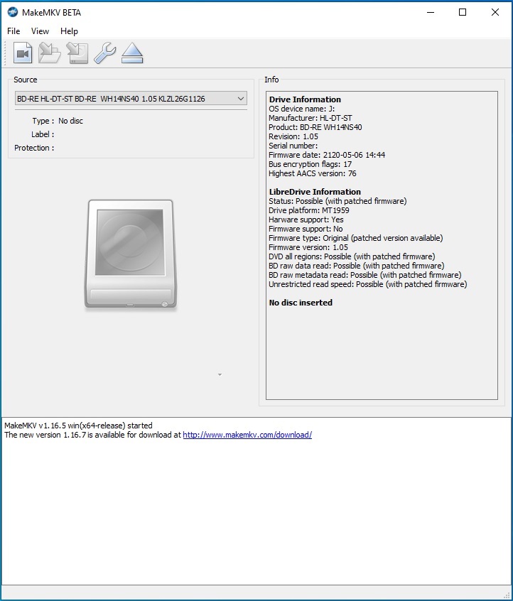

This is my first post on the forums, but have been reading a lot. I also recently purchased a WH14NS40, and am planning on flashing it with WH16NS60 1.02MK. I have a few questions that I hope someone can help answer. I currently have the drive hooked up via a BENFEI SATA III to USB 3.0 adapter, although I did this just to quickly check the specs of the drive after it arrived. When I actually flash the drive, it will be connected normally using an internal SATA to SATA connection. The SVC Code is NS50 and the Date of Manufacture is February, 2021
I first would like to do a clean dump of the firmware. There appear to be several methods to do this, but I have several questions:

You can't backup 1.05 at allSuckRaven wrote: ↑Thu Mar 24, 2022 6:05 pmHello,

Sdf GUI is the preferred way
All WH16NS60 firmware fixes the sleep bug
Only 1.03 or 1.02 will work at first on your drive you cant go direct to 1.01 or 1.00

1. You cannot get a full firmware dump anymore. You can dump the important bits (SDFtool extracts these to a 70kb .tar file). There really is no need for a full dump these days as the flashing method now used is the same as the official way.SuckRaven wrote: ↑Thu Mar 24, 2022 6:05 pmHello,

2. SDFtool flasher is a UI for the command line. Use whichever one you prefer. They do the exact same thing. I find it easier to select drive, firmware and click start button than to type out full command.
3. Yes, all NS60 firmware removes the sleep bug. For your model, NS60 1.02-MK is preferred if you use MakeMKV. If you want to use that other monkey software, NS60 1.00 is the way to go. (If this is the case, you must still flash to NS60 1.02-MK first before flashing NS60 1.00).
4. NS60 1.01-MK is never preferred over NS60 1.02-MK.
