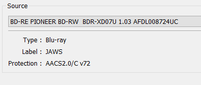

Newcomer to this forum... I am attempting to rip one of my 4K Ultra HD discs (Jaws) using MakeMKV and I am receiving errors when opening the disc with MakeMKV. I attached the log. Is this drive (Pioneer BDR-XD07UHD) incompatible for ripping 4K UHD with this encryption? If so, I will want to return the drive.

- Disc MakeMKV.PNG (4.05 KiB) Viewed 6973 times

Yes, your drive is not "UHD-Friendly", it is "UHD Official". Pioneer drives do not currently have available a "rip-friendly" firmware.

Thanks folks for the info. I *think* the firmware is 1.03 ? It says 1.03 in that bitmap I attached, but I would have to check. How do you verify firmware version?

I found this ... From MakeMKV when opening Pioneer BDR-XD07UHD.
This may show needed info.
OS device name: E:
Manufacturer: PIONEER
Product: BD-RW BDR-XD07U
Revision: 1.03
Serial number: AFDL008724UC
Firmware date: 2020-08-20
Bus encryption flags: 13
Highest AACS version: 76
Status: Might be supported in future, keep fingers crossed
Drive platform: Pioneer RS8D31
Firmware version: ID05
Disc Information
Label: JAWS
Timestamp: 2020-03-31 14:07:37
Protection: AACS2.0/C v72
Data capacity: 93.22 Gb
Disc type: BD-ROM UHD
Number of layers: 3
Bus encryption flags: 80
