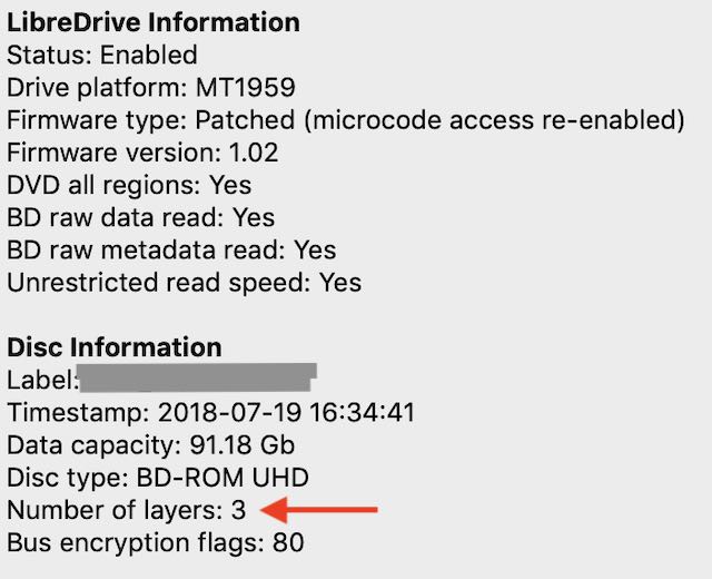

When you put a disc into your reader and MakeMKV acknowledges it in the drive but before you tell MakeMKV to do something with it… MakeMKV will tell you how many layers the disc has.
3 layer discs are often problematic, regardless of the player or firmware. Gently clean the disc, since even brand new discs can pick up a nearly invisible film either during the manufacturing process or from off-gassing while in the case.

Thanks for the info. I can confirm that both discs are 3 layers. I've cleaned the discs multiple times now taking special care to inspect the disc very closely but I'm still unable to complete a backup. Goodfellas fails at around the same spot each time but not on exactly the same "offset" with the message "Backup done but 1 files failed hash check" and this error in the output, "Error 'Scsi error - MEDIUM ERROR:L-EC UNCORRECTABLE ERROR' occurred while reading '/BDMV/STREAM/00030.m2ts' at offset '20240658432'".dcoke22 wrote: ↑Sat Feb 20, 2021 4:35 amWhen you put a disc into your reader and MakeMKV acknowledges it in the drive but before you tell MakeMKV to do something with it… MakeMKV will tell you how many layers the disc has.
