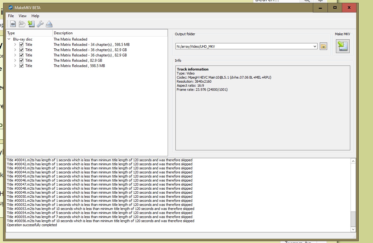

Thanks! I am seeing three possible titles so it's not like some that have hundreds. One does not have chapters so I guess that means there are two two possible titles. In that case do experienced MakeMKV users try both? I am not worried about the time to create the MKV, just that what if they swapped CHx with CHy or just dropped a CH altogether? It would be hard to determine that watching the entire movie and even then it might not be obvious unless one is very familiar with the movie.
That method also ruins the movie! I am waiting to get the DV stuff working before watching my movies.
Here is a snippit of MKV:
Posts: 4445
Re: The Matrix trilogy correct playlist
Post by dcoke22 » Sat Jan 02, 2021 10:38 pm
Click on one of the two possibilities to highlight it. In the info box on the right, you'll see a segment map. Figure out the difference in the segment map between the two.
Create a decrypted full backup of the movie: http://makemkv.com/faq/item/4 Inside that backup will be a folder named STREAM. Inside there will be .m2ts files that correspond to the segment map. Those files play just fine in VLC (https://www.videolan.org/vlc/) or MPV (https://mpv.io). Undoubtedly, you'll then know which title is for you.
You can then make a .mkv file from the decrypted backup; no need to rip from the disc again.
