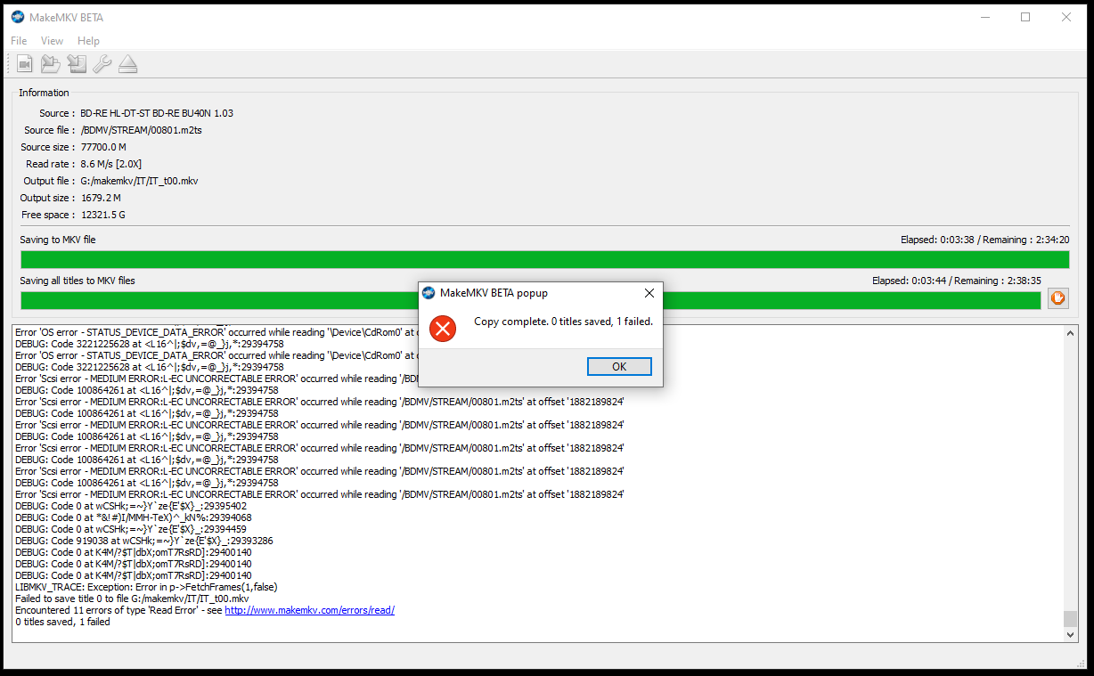

MakeMKV v1.15.1 win(x64-release) started
Debug logging enabled, log will be saved as C:\Users\***/MakeMKV_log.txt
Using direct disc access mode
DEBUG: Code 100864261 at <L16^|;$dv,=@_}j,*:213131847
DEBUG: Code 100864261 at <L16^|;$dv,=@_}j,*:121261934
Error 'Scsi error - MEDIUM ERROR:L-EC UNCORRECTABLE ERROR' occurred while reading '/BDMV/META/DL/IT_UHD_metadata416_JFIF_BT2020_HDR.jpg' at offset '0'
DEBUG: Code 0 at :cI7M]Usrct"5yb-4:121263130
Error 'Scsi error - MEDIUM ERROR:L-EC UNCORRECTABLE ERROR' occurred while reading '/BDMV/META/DL/IT_UHD_metadata640_JFIF_BT2020_HDR.jpg' at offset '0'
DEBUG: Code 1 at :cI7M]Usrct"5yb-4:121263130
DEBUG: Code 100864261 at <L16^|;$dv,=@_}j,*:213131778
Error 'Scsi error - MEDIUM ERROR:L-EC UNCORRECTABLE ERROR' occurred while reading 'BD-RE HL-DT-ST BD-RE BU40N 1.03' at offset '1513357312'
DEBUG: Code 100864261 at <L16^|;$dv,=@_}j,*:29395701
Error 'Scsi error - MEDIUM ERROR:L-EC UNCORRECTABLE ERROR' occurred while reading 'BD-RE HL-DT-ST BD-RE BU40N 1.03' at offset '1513420800'
Error 'Scsi error - MEDIUM ERROR:L-EC UNCORRECTABLE ERROR' occurred while reading 'BD-RE HL-DT-ST BD-RE BU40N 1.03' at offset '1523056640'
Error 'Scsi error - MEDIUM ERROR:L-EC UNCORRECTABLE ERROR' occurred while reading 'BD-RE HL-DT-ST BD-RE BU40N 1.03' at offset '1523103744'
SHA1 of Unit_Key_RO is 'EA83BE5875ED350EDD7A98ECC9C67DD235CE442C'

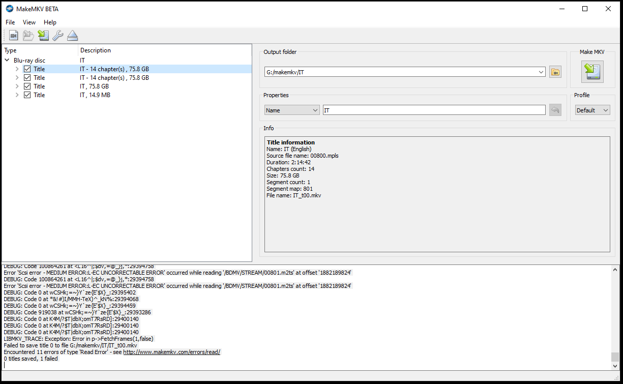

Is this rather a hardware/disc related issue or encryption?
MakeMKV is stuck at 'Processing BD+ code'
I assume it's related to decryption then?
I also added the log as attachment.

I ripped some UHD before and had no problems. I just wonder what's the issue here. Doesn't really seem to be a problem with the disk itself but rather en/decryption.
Re: "IT" Chapter 1 4K UHD
Post by shawnc22 » Tue May 12, 2020 9:47 pm
It's not a decryption/encryption issue. If it was one, you would've never gotten to the screen to pick out the titles. Offset errors are usually indications of a bad disc/drive.

The drive is not bad. I just ripped another UHD before and still got it here. I put the other one in to see if there are any issues but there aren't. However will try to do some backup of 'IT' now. Maybe that works for some reason or not.
Using LibreDrive mode (v05 id=866A98CB9C4E)
Loaded content hash table, will verify integrity of M2TS files
That's what Backup Mode is telling me as of now. Will let it run for a few hours.
