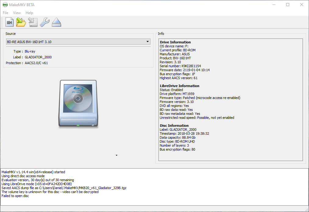

I bought this title a few weeks ago, found that MakeMKV didn't know the volume key, submitted the AACS dump to svq@makemkv.com (twice), and still no luck. I've ripped a few dozen discs so far and this is the only one that's been a problem.

djackson539
Joined: Tue Aug 27, 2019 10:28 pm
Re: Gladiator 4K UHD
Post by djackson539 » Thu Aug 29, 2019 3:46 am
Well, with no further action on my part, I tried it again today and at long last it's decoding with the latest HK file. Interestingly, this disc has a much more complex structure than any of the others I've copied, with many titles and extensive seamless branching. I wonder if the long delay in the key's availability is related to this. In any case, thanks.
