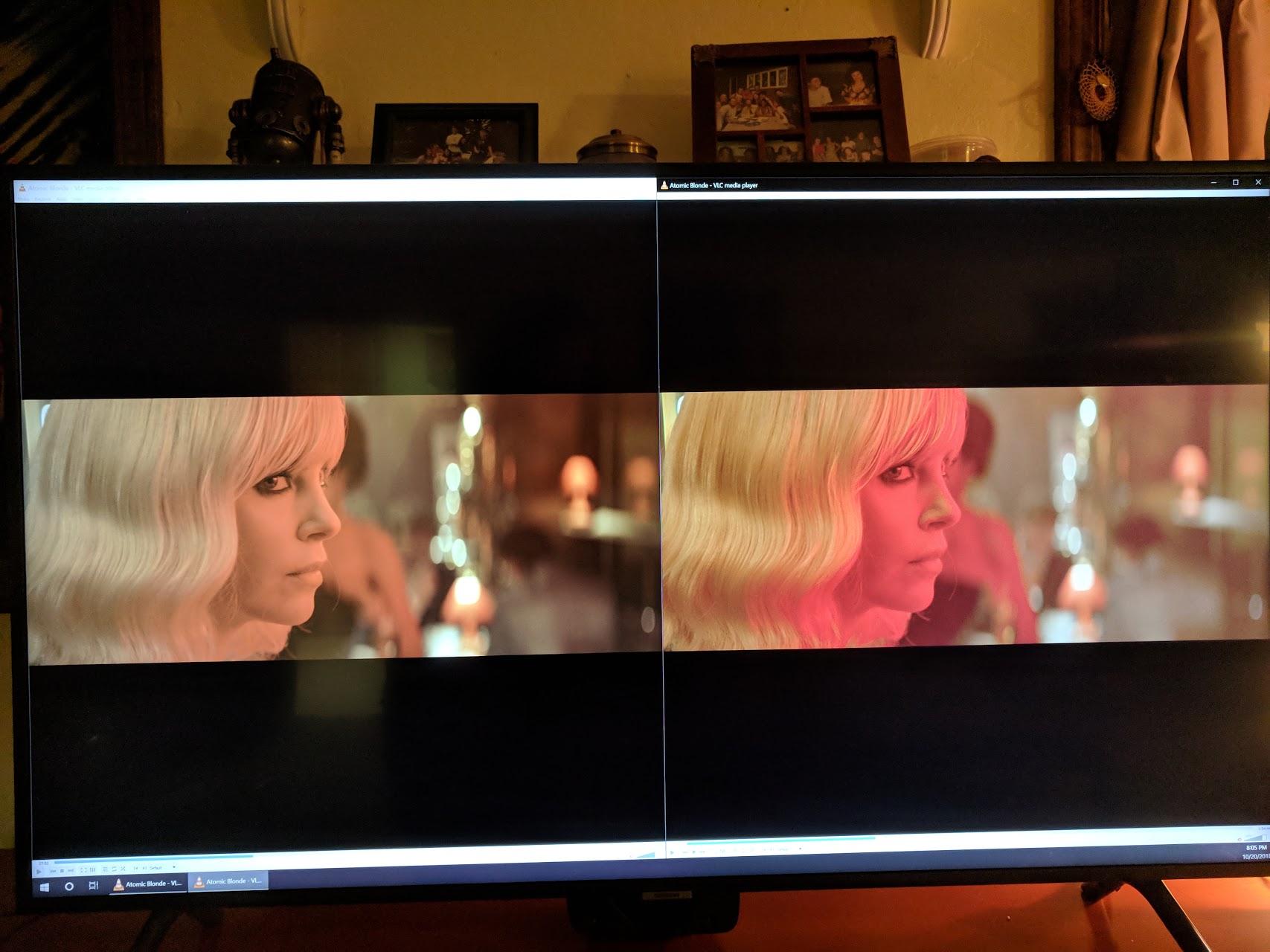

I recently got myself a 4K HDR TV and a UHD-friendly drive (thank you jonghotti).
I made my first couple MKVs of some 4K HDR discs and was excited to see how they would look vs the regular SDR blu-rays. To my surprise, the colors are much more saturated and richer on the SDR versions than the HDR versions.

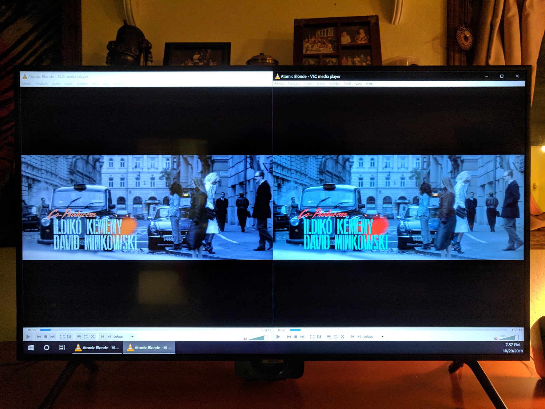

4K UHD rip on the left, regular SDR blu-ray rip on the right:
As you can see, the reds are coming out orange and the deep teal looks washed out.
HDR is enabled on the TV's HDMI port and in Windows 10 for the display.
I don't really actually notice a tremendous difference with HDR on or off other than artifacting in the SDR version when HDR is on.

My TV is only a Samsung NU7100 which apparently isn't great for HDR but it still seems weird how off the coloring is. Also, as a side note, when the TV has HDR enabled it will flicker to black intermittently if it is set to anything higher than 30Hz in Windows with or without HDR enabled in Windows.
I don't think it's PC hardware related, I'm running an i7 4790k, 16GB DDR3, GTX 1070 and this HDMI cable: https://www.amazon.com/gp/product/B003X ... UTF8&psc=1
Any thoughts or suggestions would be appreciated! Thanks!

Note that HDMI 2.0 does not have enough bandwidth to handle RGB (or YCbCr 4:4:4) at 10 bits (which is apparently necessary for HDR) and the result is exactly as you have seen. Note also that this is not just with an HTPC, e.g. if you set an Oppo 203 to RGB (the default is YCbCr) you get the same desaturated colors.
So, try setting your video card to YCbCr 4:2:2. I think that you will find that the problem is fixed. It certainly was for me.

Additionally, as it has been dicussed and advised countless of times by now in this forum. Do NOT use VLC. It has poorly designed 4k playback.
Learn to use something like MPC-BE/MPC-HC + MadVR for more proper 4k + HDR support on PCs. JRiver is another great all in one 4k player software package. That can play MKVs and full disc structures.

If you're going to be doing HDR playback on a PC, get a player that supports madvr (jriver, mpc, kodi, etc). It has excellent HDR support with dynamic HDR being developed as we speak.

Huzzah! I installed MPC-BE and it seems to work great! Colors look much better on both my TV and regular monitor. Can't tell if having HDR enabled on my TV actually improves anything but I'm just happy the colors aren't washed out.
