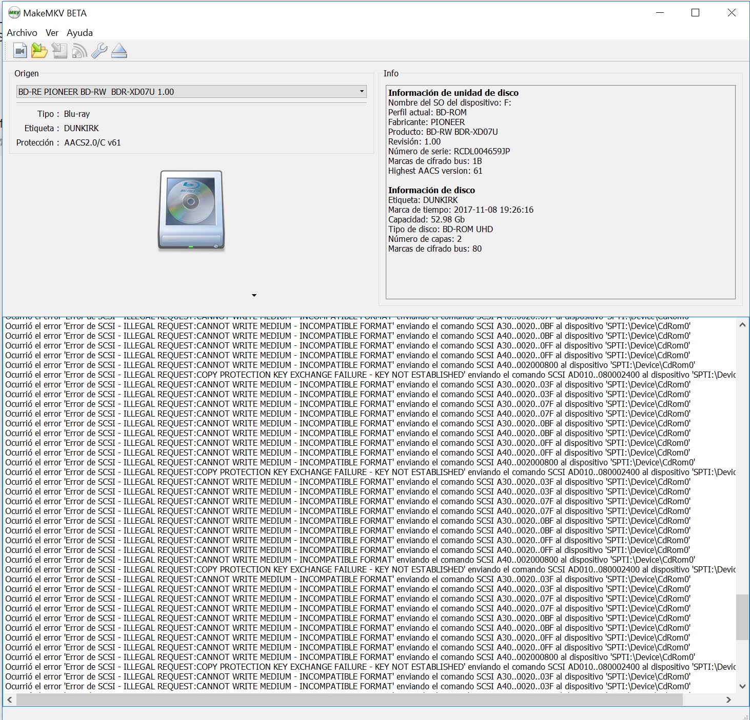

I bought this recorder Pioneer Bdr-Xd07J
I do not know how the program is used.
I want it is an exact copy of the original movie that I have
I install the latest version I press backup I get a lot of errors.
If I press where the mouse is.
Someone can explain step by step how to do it.
I also do not know where I have to put Hashed Keys exactly.
There are also people who have this file "keydb.cfg" I do not know what it is
This is error:
"The error occurred 'SCSI Error - ILLEGAL REQUEST: COPY PROTECTION KEY EXCHANGE FAILURE - KEY NOT ESTABLISHED' sending the SCSI command AD010..080002400 to the device 'SPTI: \ Device \ CdRom0'
The AACS VID on the disk can not be read - probably the disk drive has revoked the AACS host certificate
AACS dump file saved as D: /uhd/MKB20_v61_Dunkirk_7EFD.tgz
The volume key of this disc is unknown. Unable to decrypt the video
Failed to open the disk "
I beg you to help me
Thank you very much
I do not work makemkv

I believe that your drive is not UHD friendly. I'm pretty sure that no Pioneer drives are UHD friendly. Your Pioneer Bdr-Xd07J is an official UHD drive which is not compatible at the moment.

What a disappointment.MartyMcNuts wrote:I believe that your drive is not UHD friendly. I'm pretty sure that no Pioneer drives are UHD friendly. Your Pioneer Bdr-Xd07J is an official UHD drive which is not compatible at the moment.

Buy this unit thinking it was the best option to burn the discs uhd 4k

This recorder is recommended for this program Buffalo BRUHD-PU3
In this page says that if https://www.deuhd.ru/supported.html
