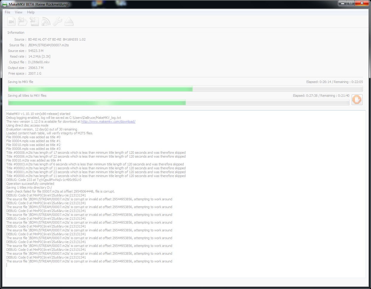

Oh no, tried another one, Boston, Makemkv, stops responding, attached screenshot, log isnt accesible until now

Re: Just Errors with New 1.12
In this case, the console output is telling you what is wrong - the m2ts file for the title you are trying to rip is corrupt - it's a bad disc.
i said it already !!!
SAME DISC, SAME DRIVE, ANYDVDHD WORKS FINE !!!!
Problems only with Makemkv, with 95% of my discs, suddenly..., please read my posts...
