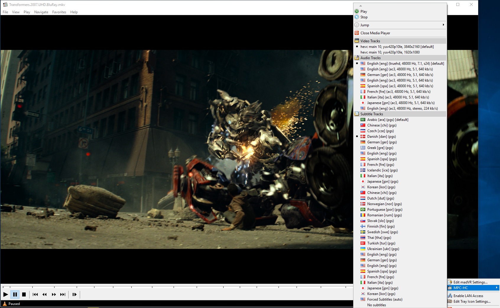

I can see both layers (HDR10 + DV) if I use MKVToolNix. MakeMKV can only see HDR10.

wiesel wrote:I can see both layers (HDR10 + DV) if I use MKVToolNix. MakeMKV can only see HDR10.
Look again, it says 1080p not anywhere specifying dolby vision or HDR10 there so I don't know what your screenshot is supposed to show us.
