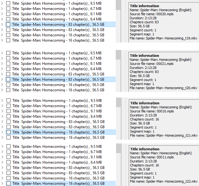

i also just got my copy of this from Amazon in the U.S., and trying to figure out which title is correct....here are the 4 titles i see in MakeMKV (there's a 5th one also, but it does not contain any chapters, and i always ignore those):
Spider-Man Homecoming.png (55.82 KiB) Viewed 21983 times
Posts: 4524
Re: UHD - Spider-Man Homecoming - Correct playlist
#13 Post by dcoke22 » Mon Apr 04, 2022 5:52 am
The segment map is the same on all four of your examples… therefore, they're all the same. The only difference is (probably) what languages are surfaced to you and how many chapters there are. But since they're the same segment map, they're the same audio and video.
Probably 16 chapters is more useful than 83. Pick which ever one has the language(s) you want and rip.
