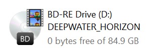

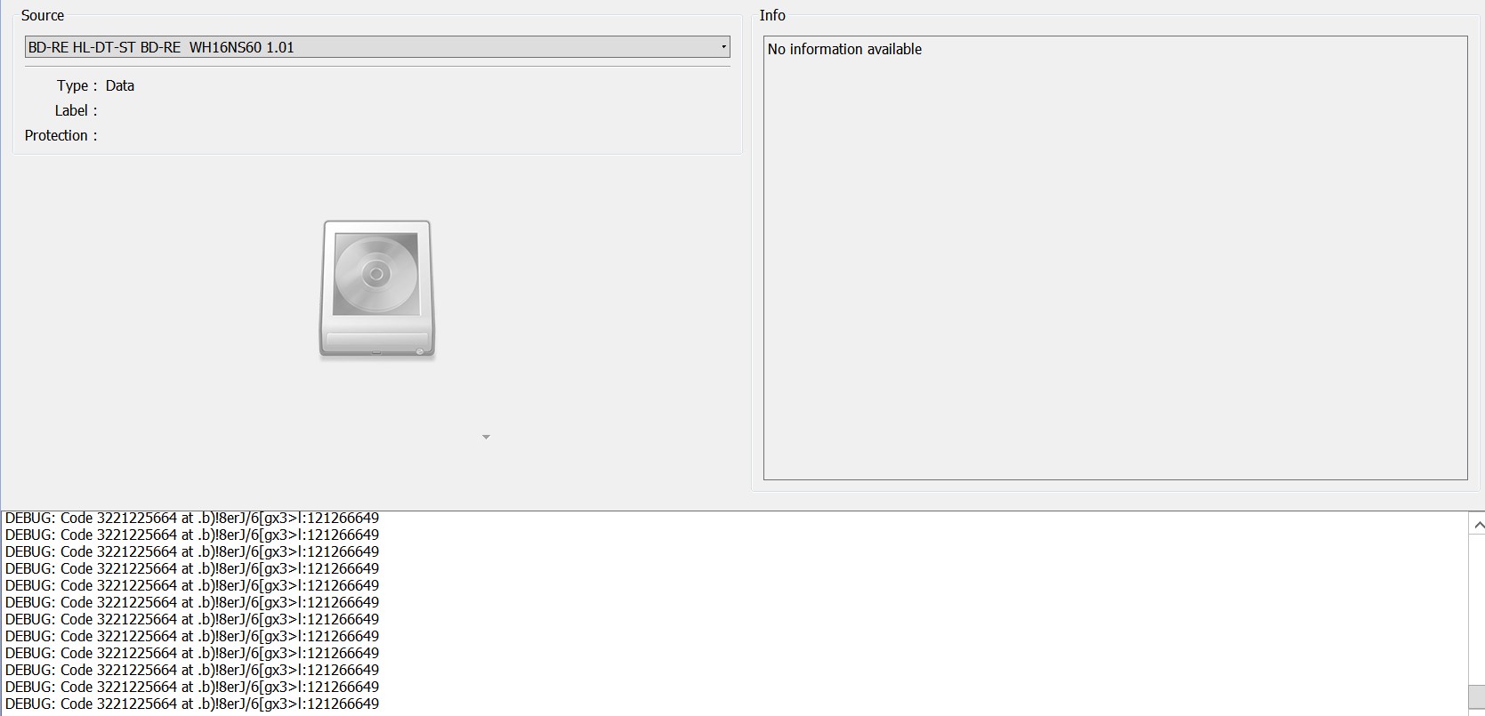

I tried this again in my LG drive (again), and it shows up in Windows Explorer, but MakeMKV just keeps spitting out the error code: DEBUG: Code 3221225664 at .b)!8erJ/6[gx3>l:121266649 repeated indefinitely... I should also note, after this error the drive no longer shows up in windows until I reboot.
