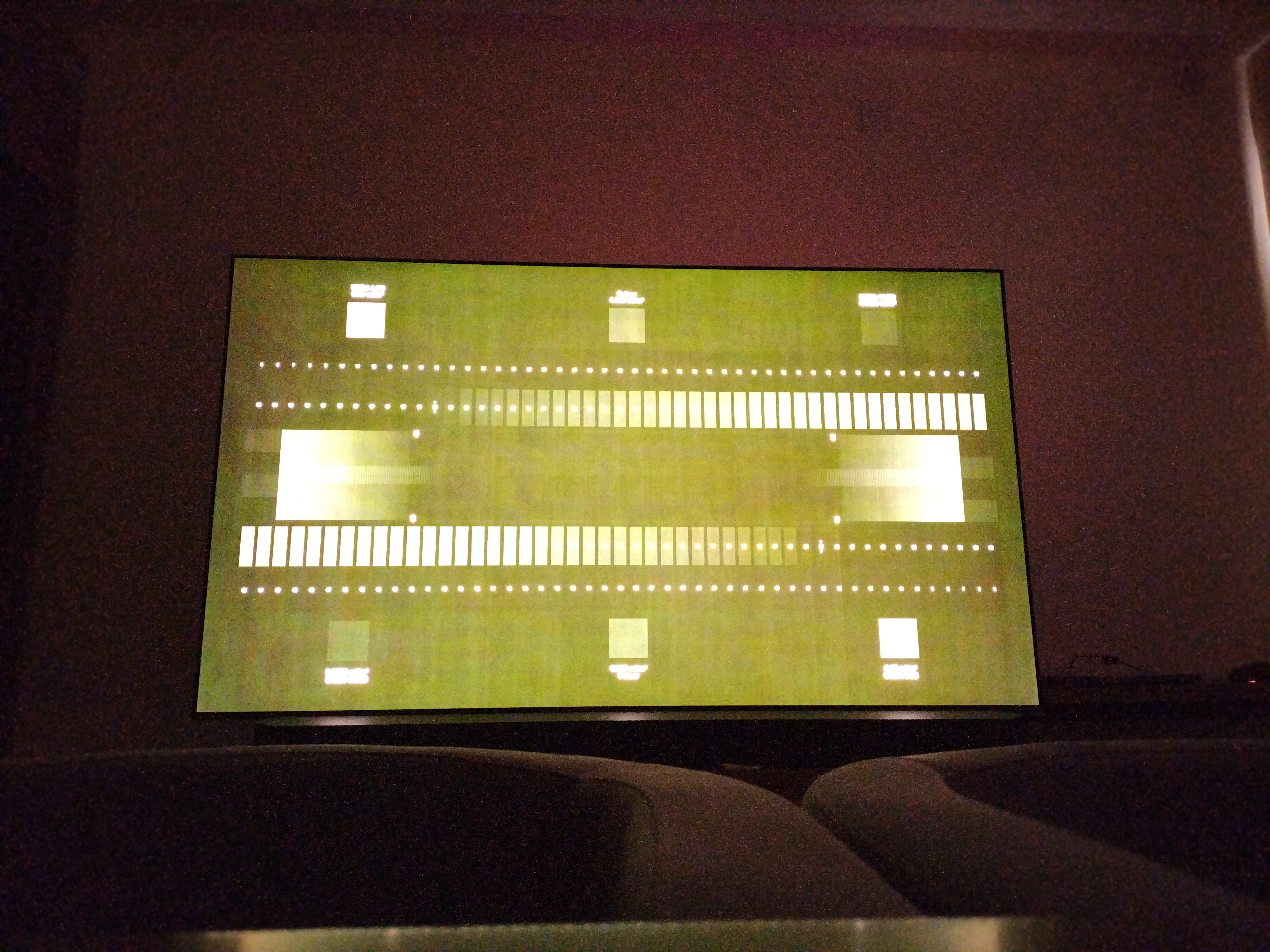

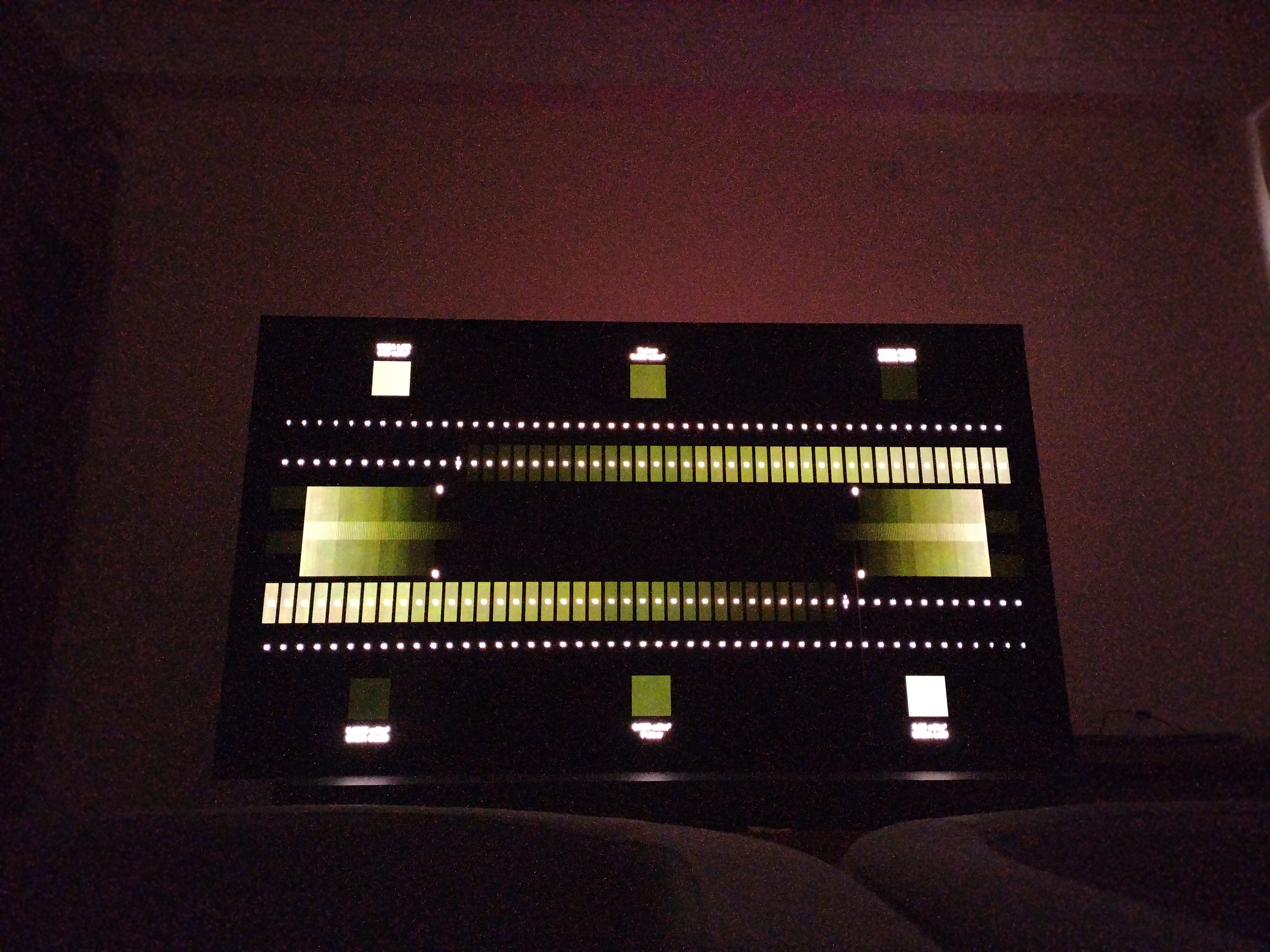

HDR10 6400ISO 32 seconds exposure (no HDR calibration configuration file):

HDR10 in that photo looks way off, I came across once when I dragged Movies & TV app from laptop SDR display to external HDR display while it was playing. But it's not the same this time, on my end the raised black level is unlikely to be perceived if not in a really dark room.
as I said, in LLDV player led if your edid min target is not 0, you'll get raised blacks. I replicated on my C2 too, if I use the default c2 edid its raised, if I use a custom edid with min target set to 0 and reboot, then black is black. My C2 is in a room with black velvet on floor ceiling and walls. No windows, no lights.
