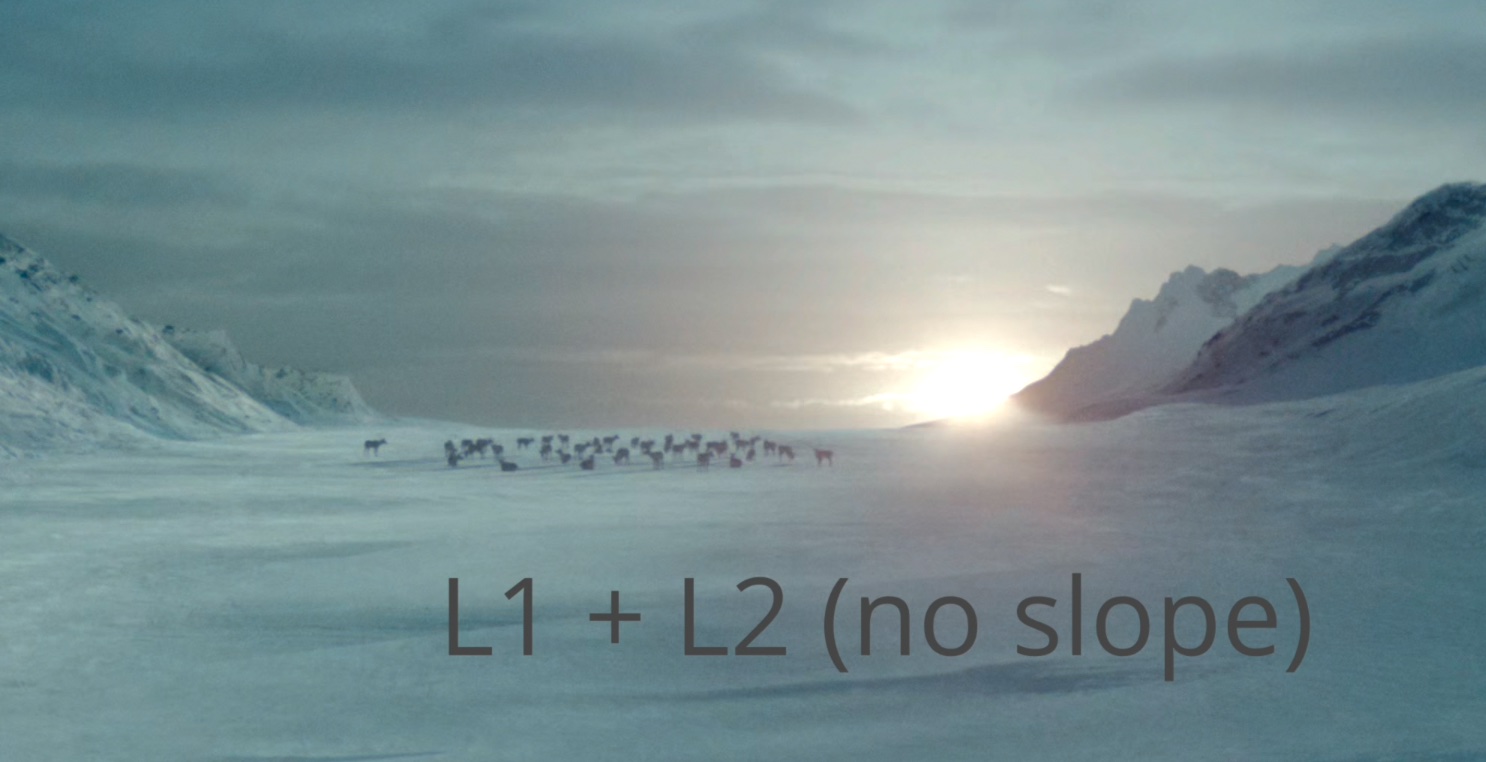

- true-detective.jpg (173.15 KiB) Viewed 11342 times

no photo is needed, you should see a visible change for L1 + L2 (no offset) on your TV internal player but not on your Oppo or ATV in tv-led. Same story if you take any of the patterns quietvoid and I did but these new test files are with real content.
True Detective sample: Offset response is quite obvious on the internal TV player
Role Play: almost unnoticeable, the vegetation in the background is brighter with L2 offset on the internal TV player
Mi death reckoning: you cannot miss this one, there is a huge positive lift.
Batman (just added in my GD): very slight change with trims offset on TV internal player only
