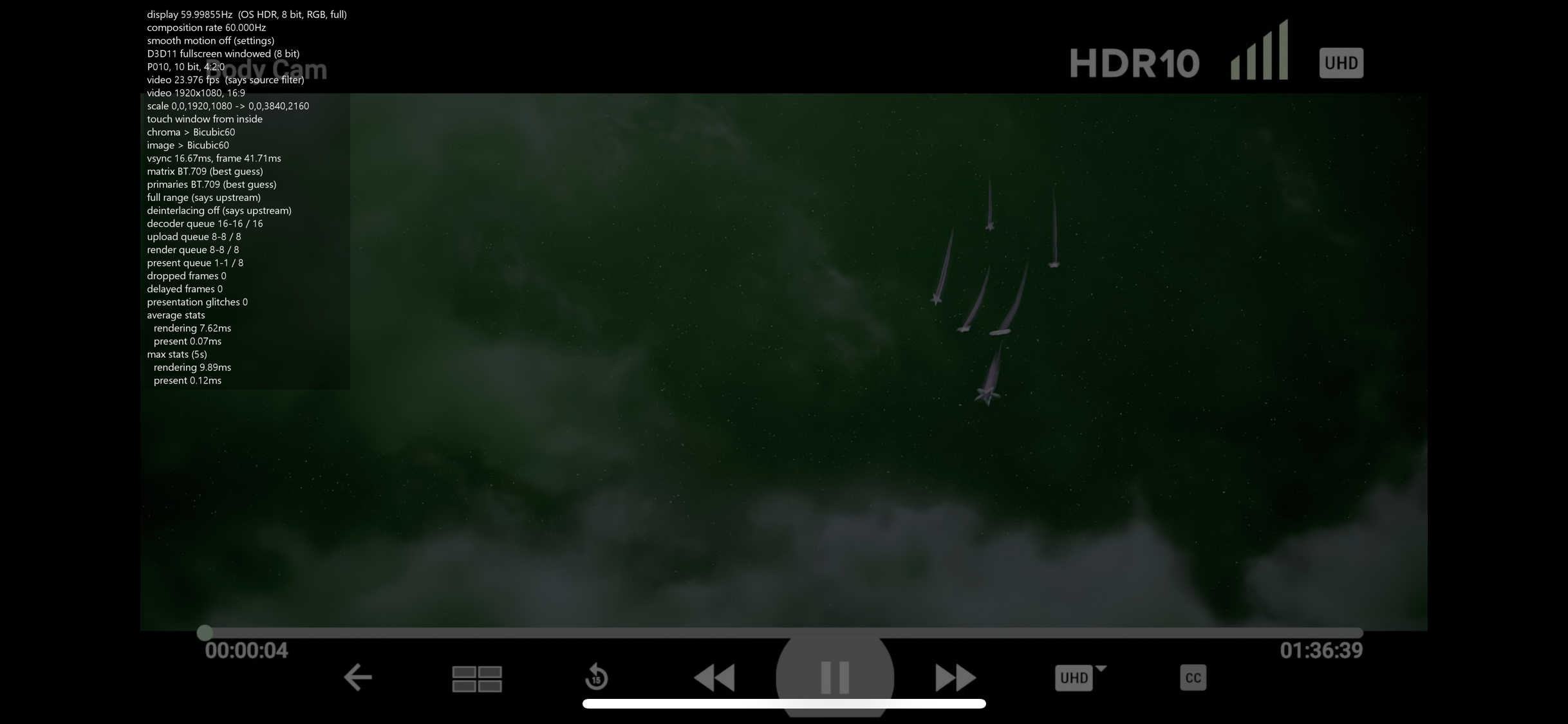

I just made a profile 5 doblyvision encode (now-possible) encoded on a pc
This test was made from a hdr10 base layer.
And it works on apple
tv
I’ll wait for reset9999 to compare
- 6B045A9E-E77A-4C6C-A3E3-179A9109B163.jpeg (2.72 MiB) Viewed 15973 times

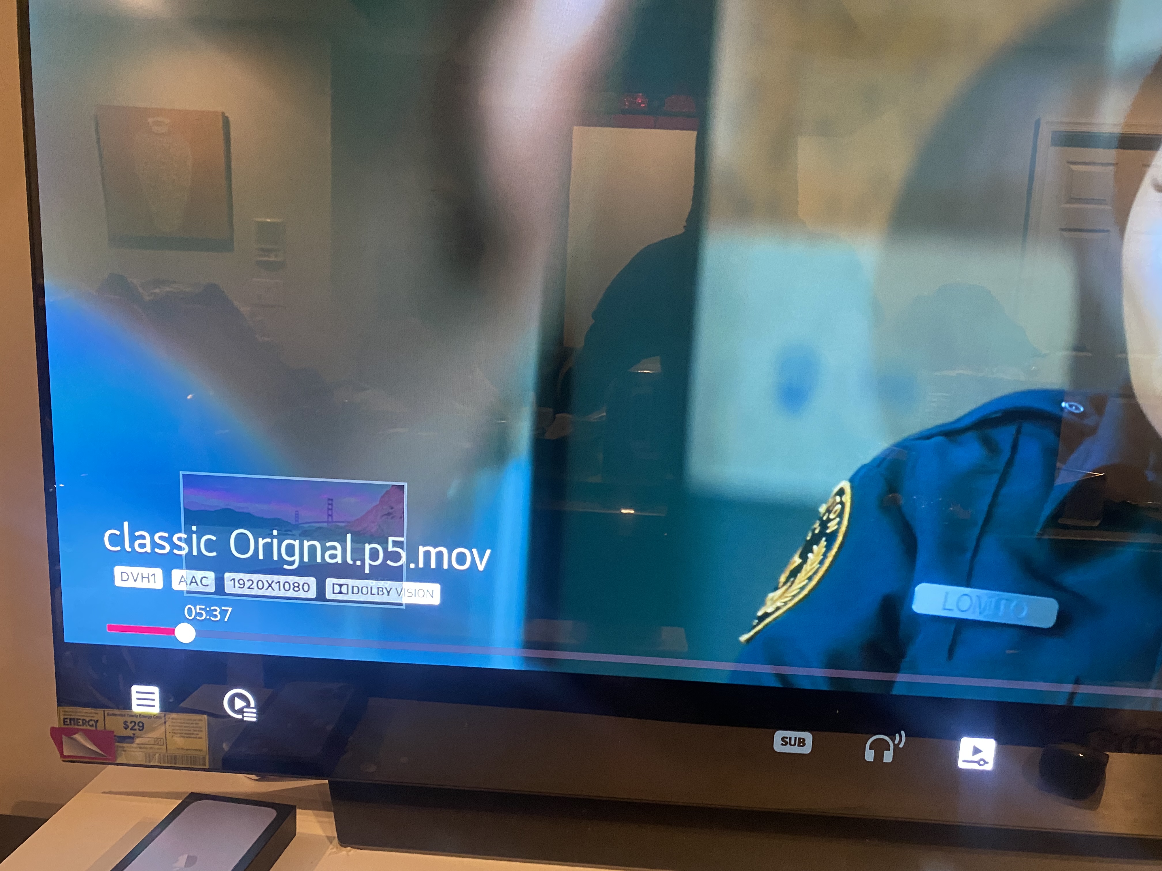

Manixx2020beyound wrote: Tue May 24, 2022 11:57 pm I just made a profile 5 doblyvision encode (now-possible) encoded on a pc
And it works on appletv
My p5 are triggering doblyvision on the pc app. This is unbelievable

Here is a p5 sample for u guys to test
This was encoded using doblyvision encoding engine & h265, RPU is a true P5 even l4 included
Source file spares & munsil m2ts untouched Mel.
Test on Apple TV’s
https://drive.google.com/file/d/1476mVd ... sp=sharing
Test on Apple TV’s
