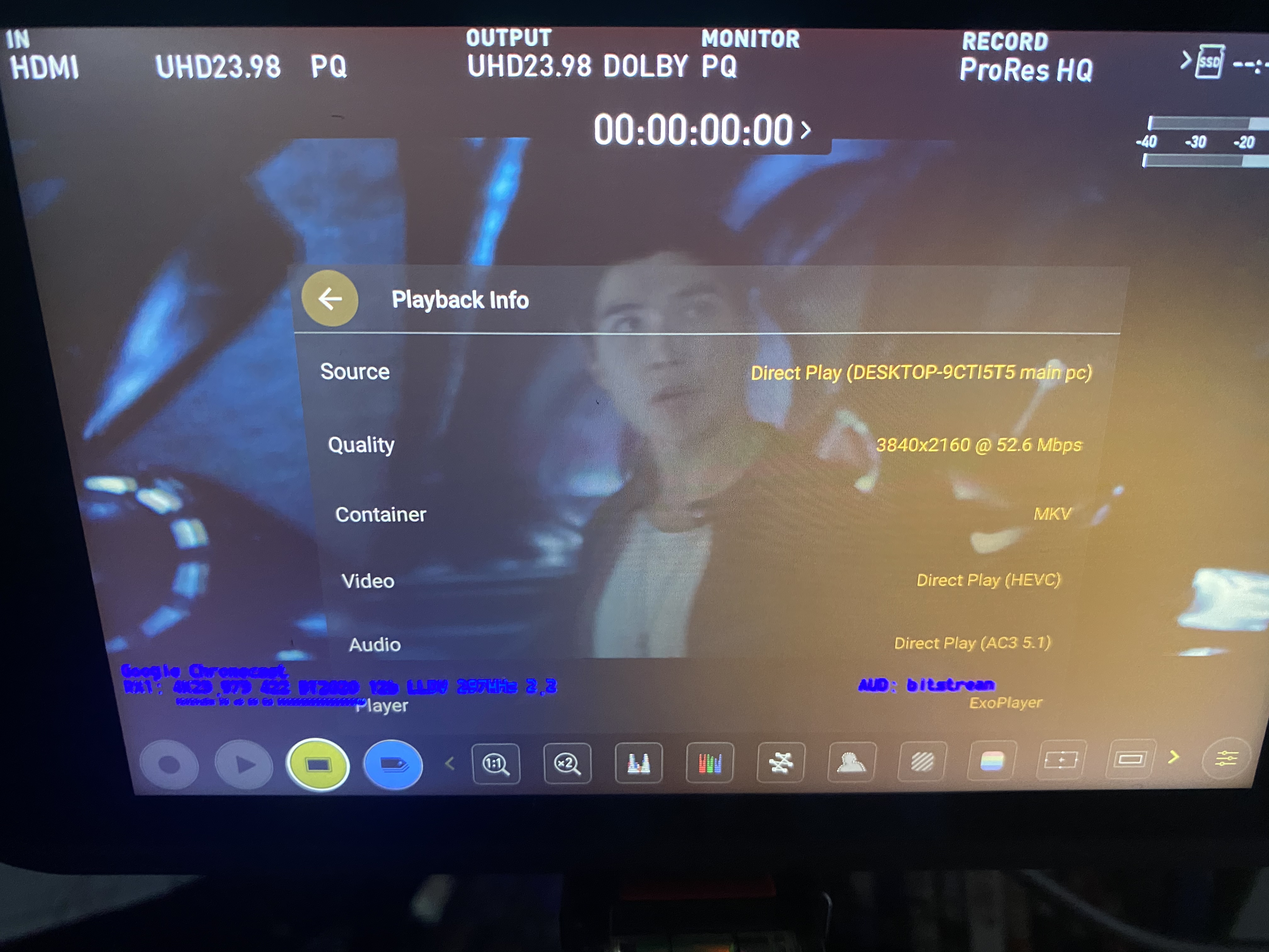

Did you see compression artifacts in the DV FEL version in Chromecast? It looks like the P8 file or how?
And, what about the fact that I can't see any compression artifacts in the Dolby Vision FEL mkv I made? It could be yor setup?

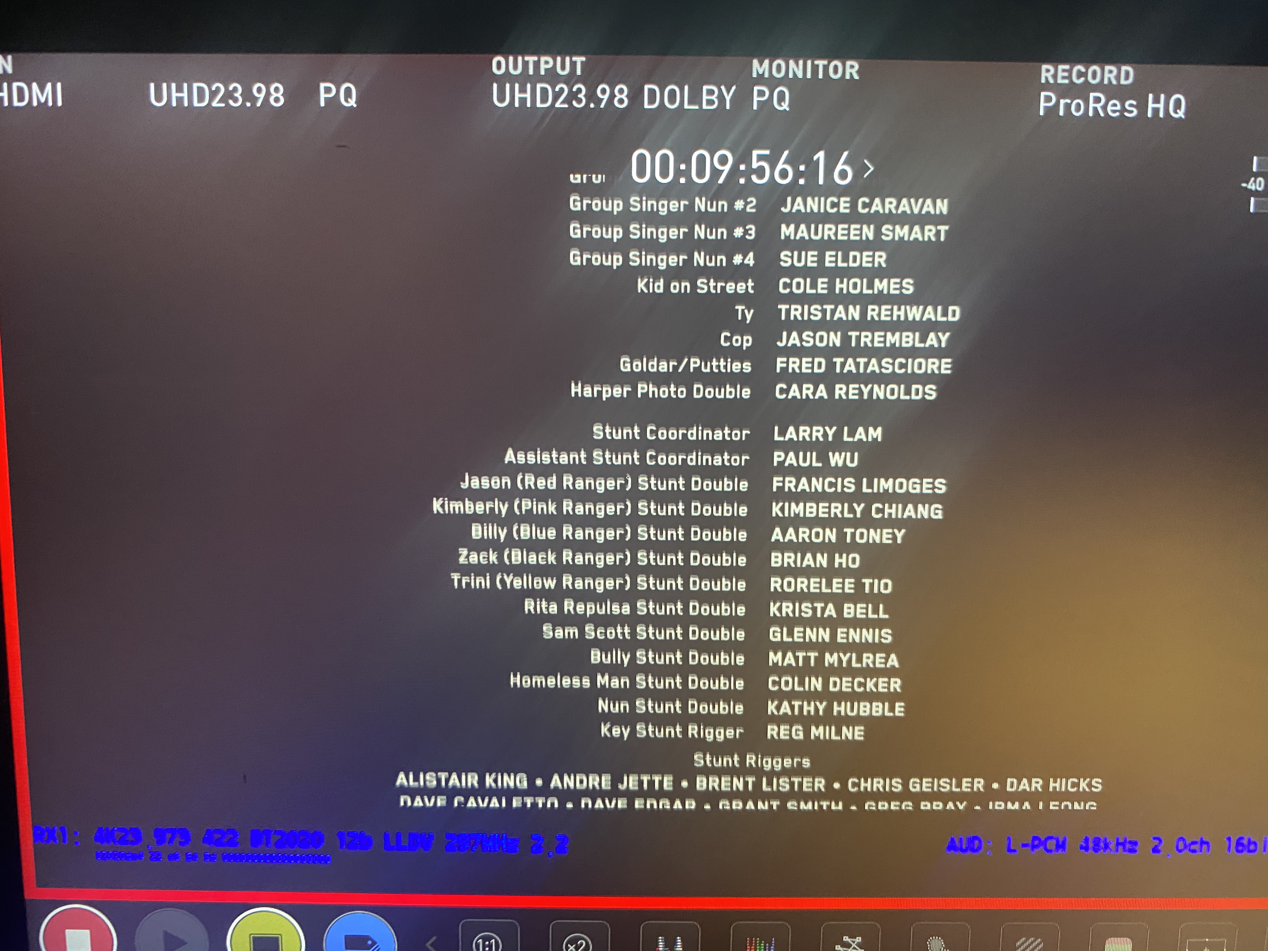

I don't own a Chromecast, I only have the Atomos shogun capture(from manix) of the Chromecast playing total recall FEL. Clearly, manix messed up the colors but unless he used a p8 file by mistake(unlikely), it shows that FEL is not processed.
Maybe the small samples break something in FEL because in motion I still see some artifacts on the x700 with the samples, definitely not free of compression artifacts.. I will try the complete movie tonight.

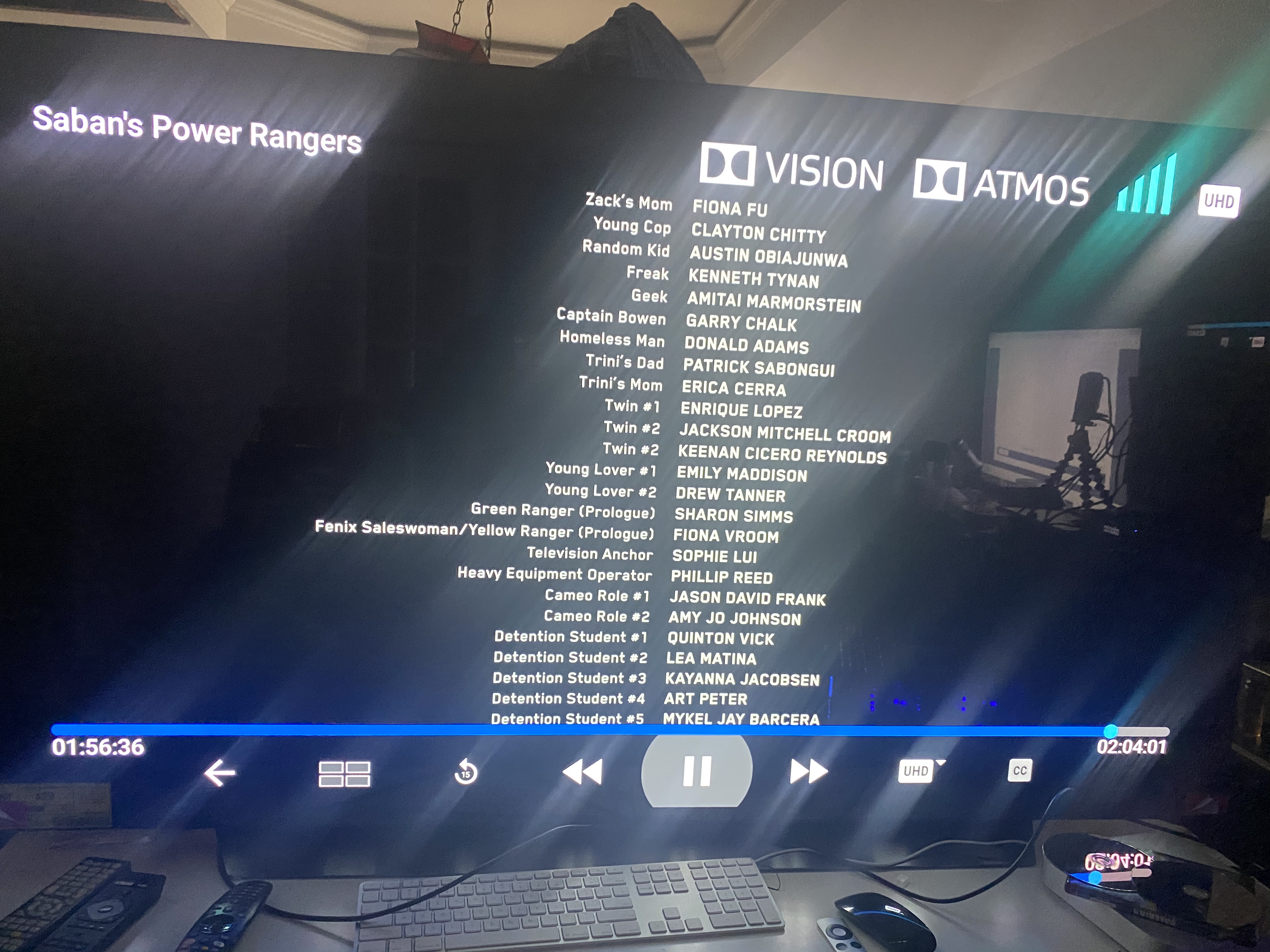

P5 is the same as using p7 fel
Even doe the itcp is different seem like in the final encoding process the 12/16bit rgb tif DV meta is transferred to the p5 as well ending credits for power rangers on VUDU is bright white as well.
So would also mean the p5 uses the fel prior to encoding to p5 which is meta from the xml
So p5 is also better than regular hdr10.
Also means p5 is not just hdr10 with Rpu

I always found it strange that the white of the end credits was encoded in the FEL, I can’t see what the need was or why the encoder would choose to do that. It does seem that for a lot of movies the FEL is required for a decent presentation.

I presume if you were to watch the VUDU version in HDR10 the credits would be bright white also.
Post by Manixx2020beyound »
mattmarsden wrote:
Tue Mar 16, 2021 6:37 pm
Checking that now
Yes it bright white in hdr10 too
Weird
Also the playback device is the shield tv
So streaming hdr10
Is different from uhd hdr10 as well.

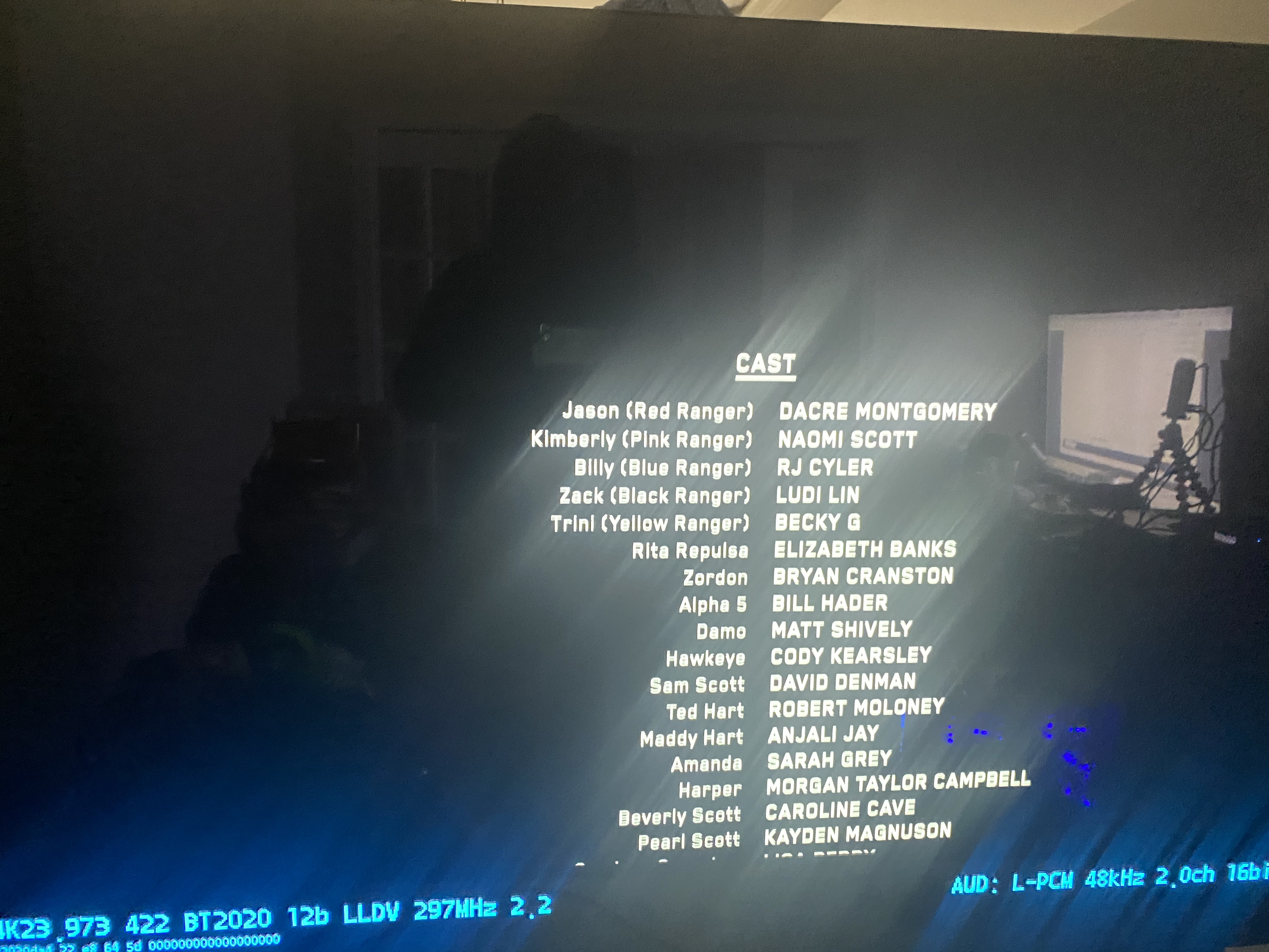

So Chromecast can read fel?
hepe9 wrote:
Tue Mar 16, 2021 10:10 pm
Manixx2020beyound wrote:
Tue Mar 16, 2021 3:39 pm
Trying 1 last time
Set timer came back tv was off lol
Strange thing doe if I force LLDV from the device it plays the whole movie but NO fel
Trying when it triggers naturally is the issuse .
But I’ll keep trying seeing that the ugoos is no go.
Sonyx700 or streaming platform still the best option for fel movies.
