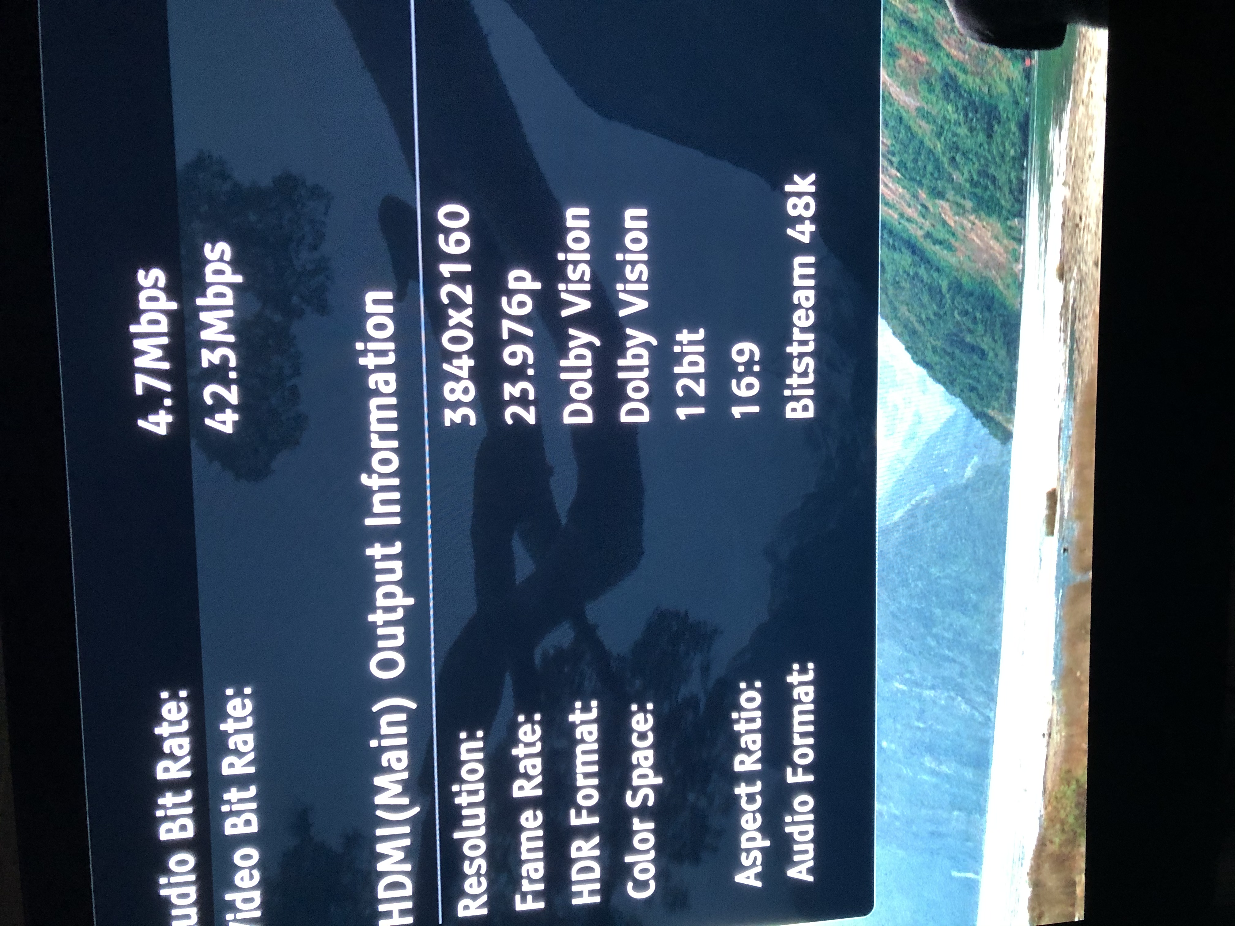

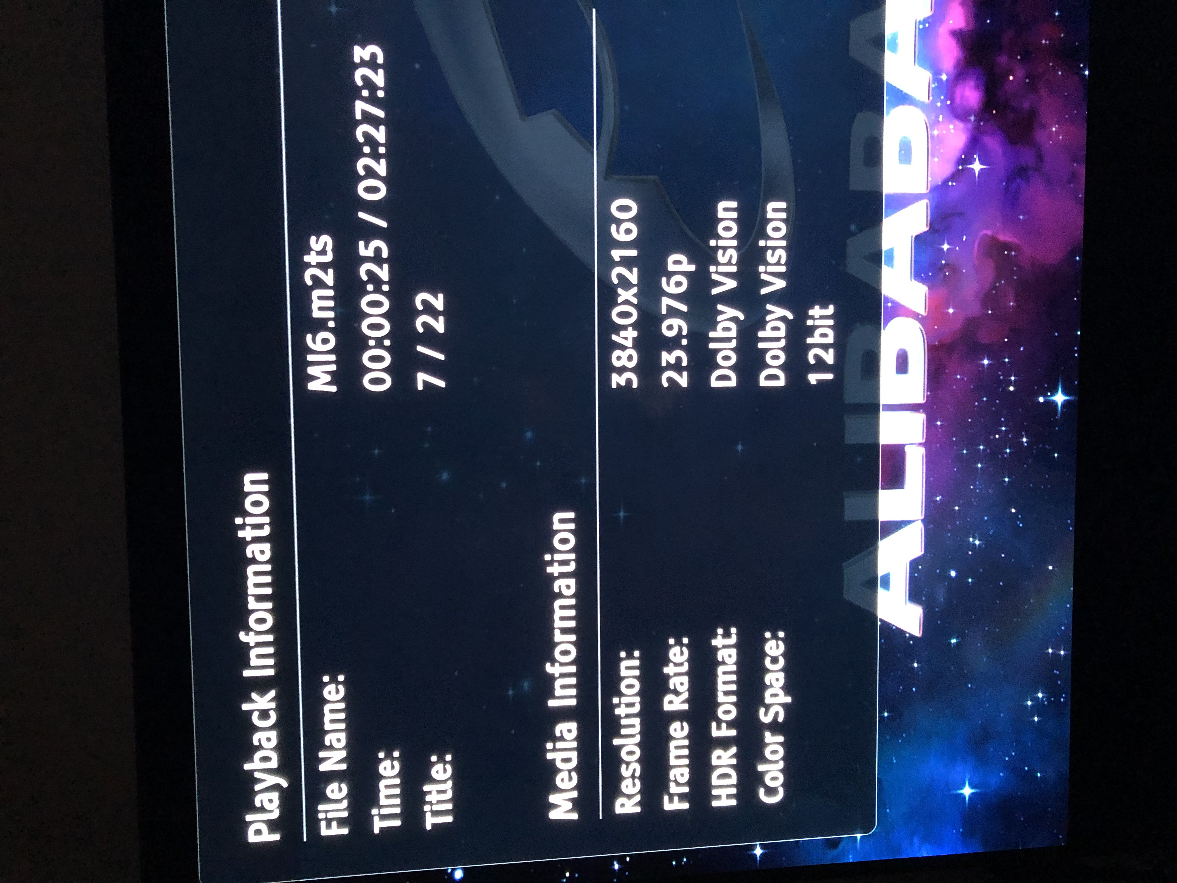

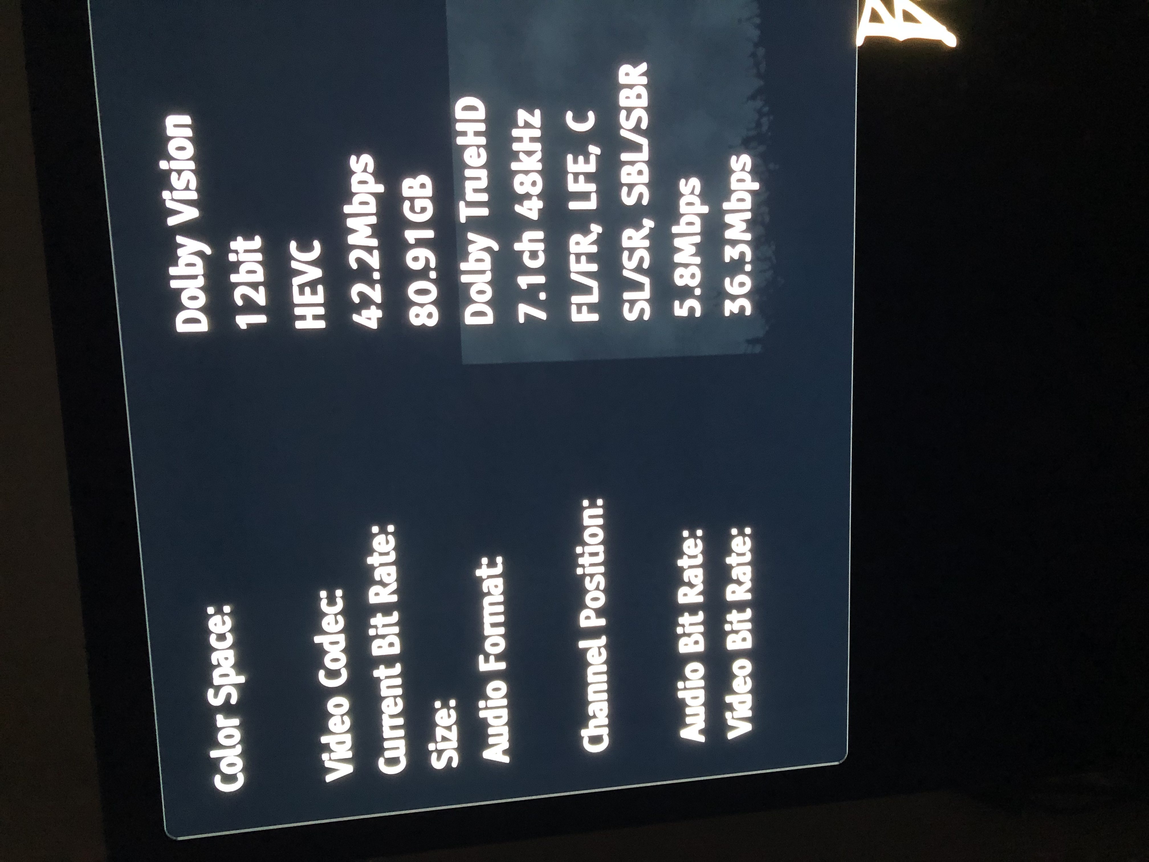

Hi Yusesope, here are the shots from the Oppo, 1917 that won’t play and reports as 8bit output, which makes sense and Missin Impissibke Fallout which plays fine, both are supposed to be FEL.
Here are the Mission Impossible Fallout pics

I'm sorry but at the moment I don't have any other ideas.
The strange thing is that the video bit rate of 1917 is 0kbps.
If the cobination of my tool + tsMuxeR worked for Mission Impossible, it may also work for other FEL titles.
You should make some attempts.
