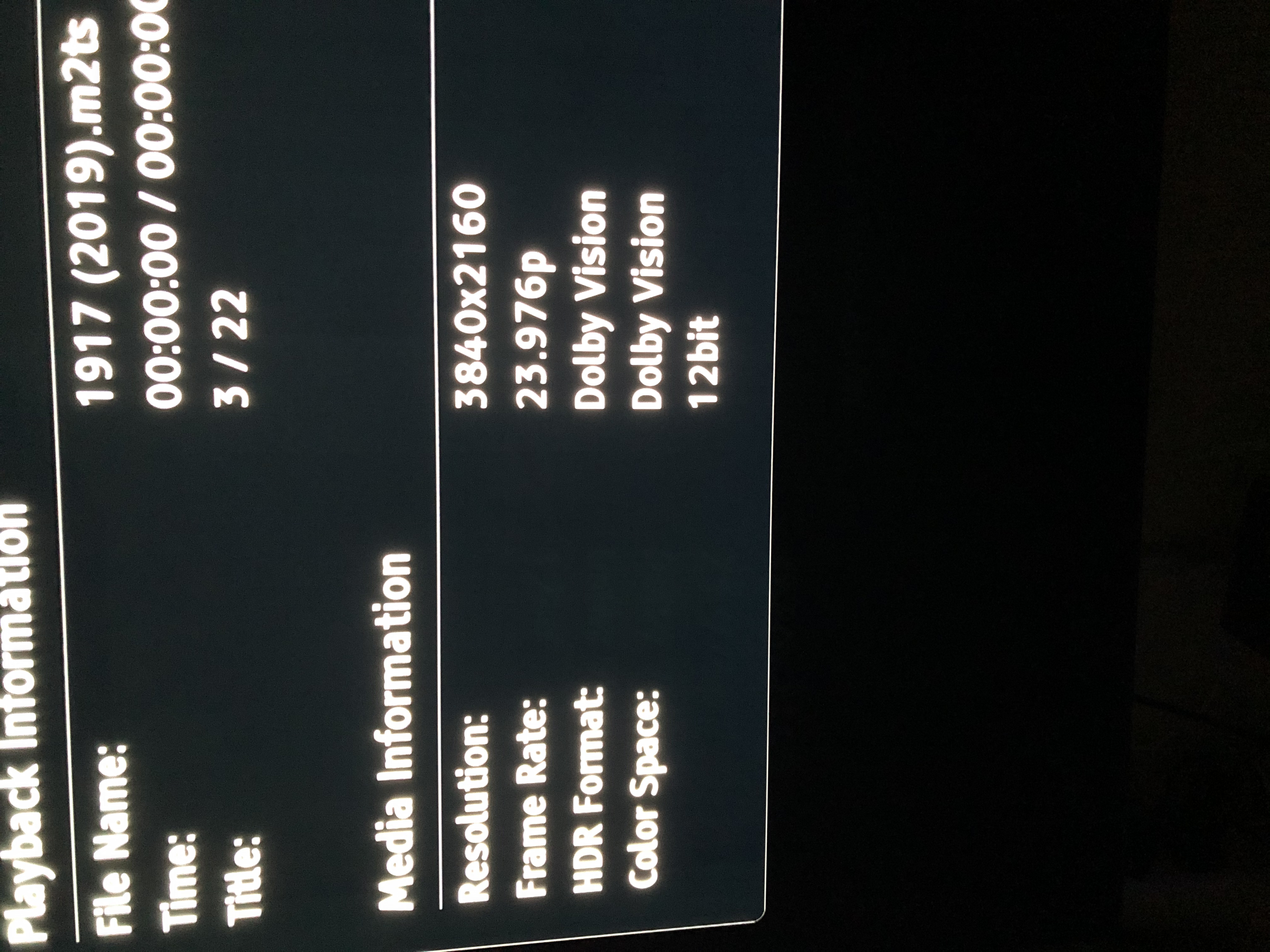

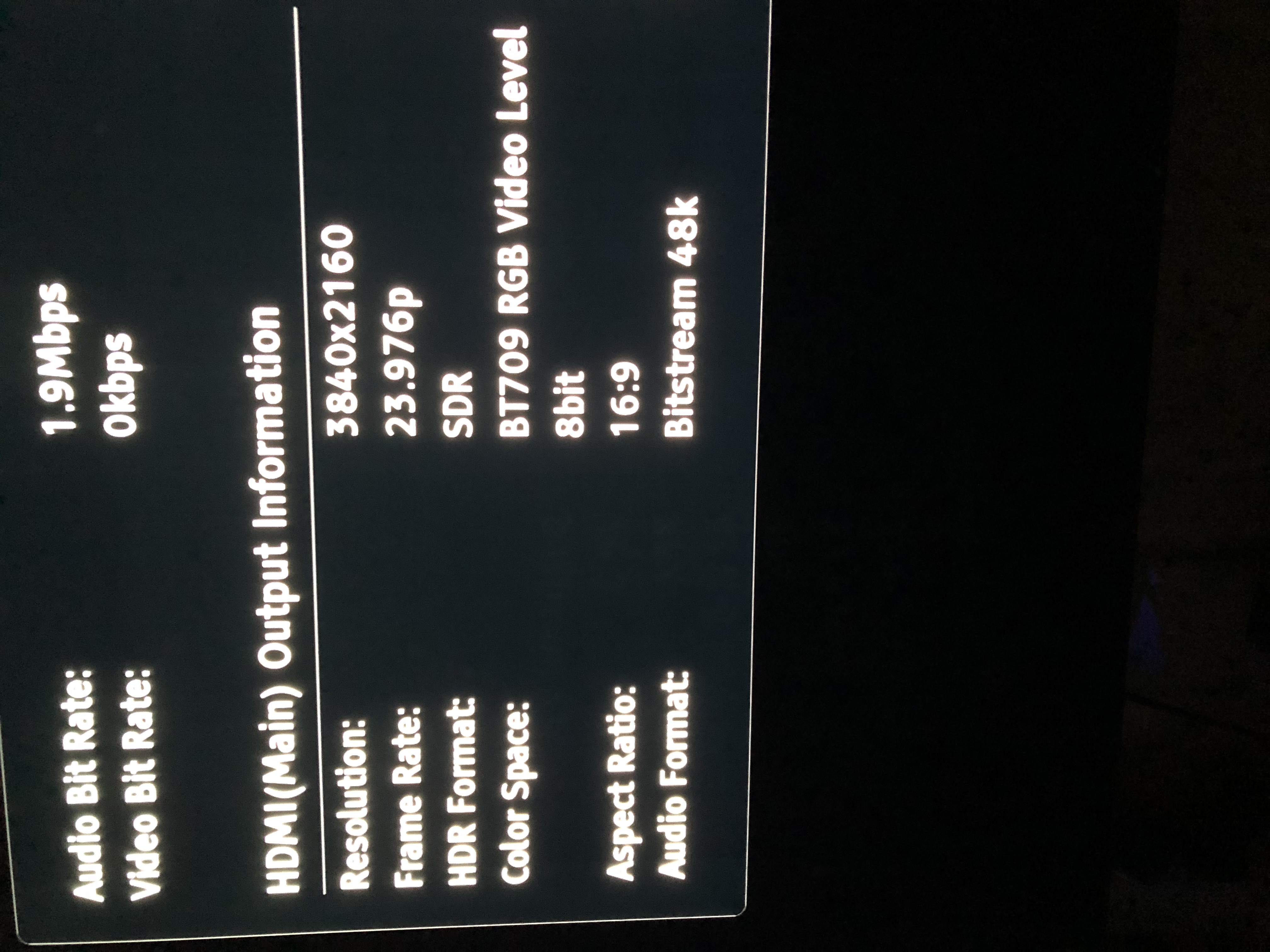

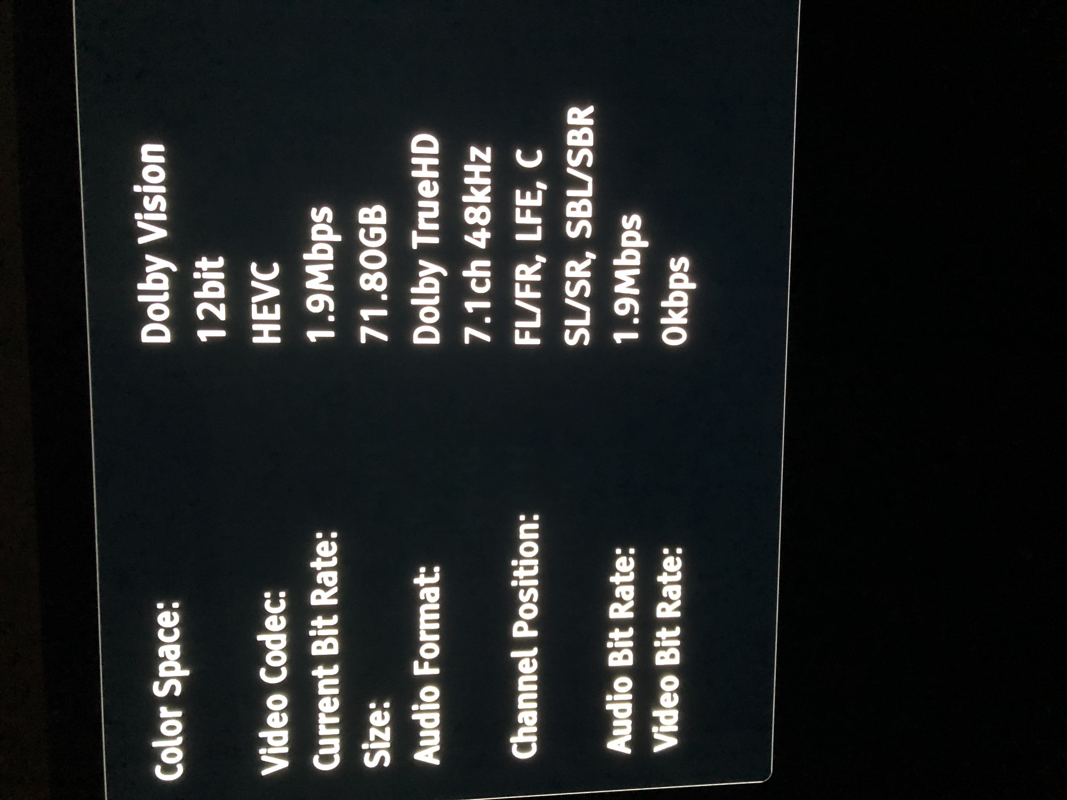

DaMacFunkin
Posts: 312
Post by DaMacFunkin »
yusesope wrote:
Tue Mar 24, 2020 12:17 pm
DaMacFunkin wrote:
Sun Mar 22, 2020 9:17 pm
Hi, Following the guide can't get FEL to work on the oppp, the file does work in HDR10 on the 2017 shield, can't check on the 2019 shield as it is at my weekend address (won't be there again till Friday)…
Thanks for trying.
If you have time, could you please try what follows with a MEL movie?
yusesope wrote:
Sun Mar 22, 2020 10:45 am
Since you own an OPPO 203, could you do me this favour: while playing a movie (my tool + tsMuxer, please try both a FEL and an MEL movie), can you press the "info" button and take a screenshot (both for the Multimedia information section and for the HDMI output information section)?
It is important, however, that in the player settings, Color Space and Color depth (Video Output Setup) are set to AUTO.
Help yourself with this video (19:24):
https://youtu.be/Pqg8Ky6T7vc?t=1164
Thank you
Hi Yusesope, here are the shots from the Oppo, 1917 that won’t play and reports as 8bit output, which makes sense and Missin Impissibke Fallout which plays fine, both are supposed to be FEL.
