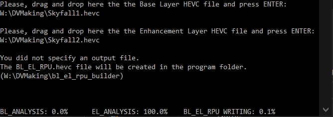

@yusesope
I'm still getting this with all the Bond movies I've tried, EL analysis shoots up to 100% right away, and BL stays at 0. Any idea what's going on here?
Which movie, I can try as well.
Let me know what movie that just happened too
Arbigator
Posts: 32
Post by Arbigator »
That was Skyfall, happened on Spectre as well. Can you tell me the command you use to extract the video streams with eac3to?

Arbigator wrote:
Sat Mar 14, 2020 6:21 pm
Latest version of eac3to (3.34)
eac3to \path\to\bluray\ (might need " " around the directory if you have spaces in the directory or file names)
Once you get the path, usually 1)
eac3to \path\to\bluray 1) 2:BL.hevc 3:EL.hevc
The 2 layers are usually 2 & 3 (1 is always chapters)

Arbigator wrote:
Sat Mar 14, 2020 6:16 pm
The EL layer is empty. There are two possibilities: the original file is corrupt or you are wrong to demux the original file.
