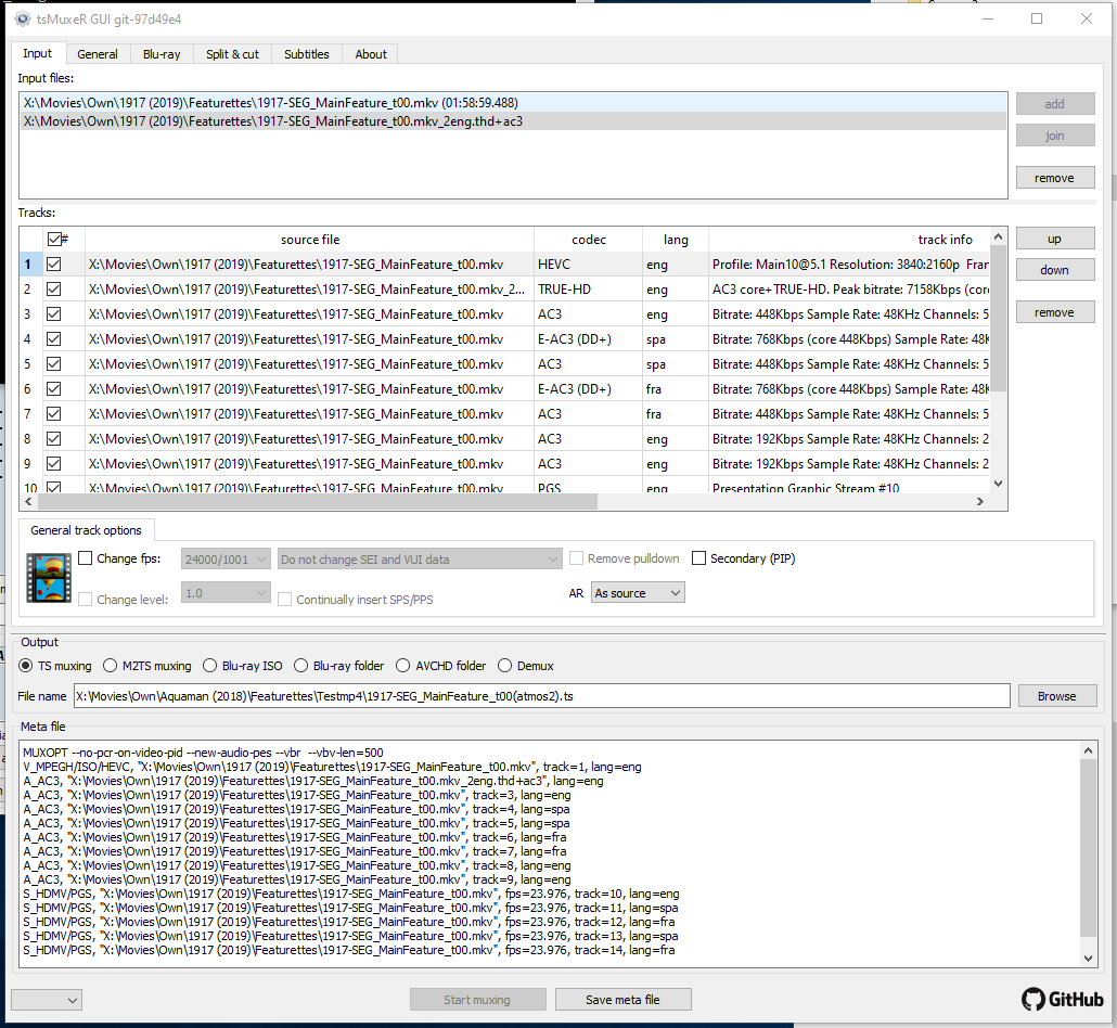

I'm not sure what i'm doing wrong, but when I use tsMuxeR the .ts file that is created doesn't play video. With MPV and VLC I only get audio. My TV will not even play the file.
picture shows my settings.
media info
General
Complete name                            : X:\Movies\Own\1917 (2019)\Featurettes\1917-SEG_MainFeature_t01.ts
File size                                : 66.2 GiB
Overall bit rate                         : 79.6 Mb/s
Video
HDR format                               : Dolby Vision, Version 1.0, dvhe.06.06, BL+EL+RPU / SMPTE ST 2094 App 4, Version 1, HDR10+ Profile B compatible
Codec ID                                 : 6
Bit rate                                 : 75.2 Mb/s
Bits/(Pixel*Frame)                       : 0.378
Stream size                              : 62.5 GiB (94%)
Maximum Frame-Average Light Level        : 168 cd/m2

andcbii wrote:
Sun Apr 19, 2020 4:32 am
I'm not sure what i'm doing wrong, but when I use tsMuxeR the .ts file that is created doesn't play video. With MPV and VLC I only get audio. My TV will not even play the file. Capture.PNG picture shows my settings.
media info
General
Video
Codec ID                                 : 6
Audio
Codec ID                                 : 129
Bit depth                                : 16 bits
Stream size                              : 381 MiB (1%)
I have the same problem with my TV's (GZ950B ) internal player, my media info for the HDR format is:
Dolby Vision, Version 1.0, dvhe.06.06, BL+EL+RPU / SMPTE ST 2086, HDR10 compatible
