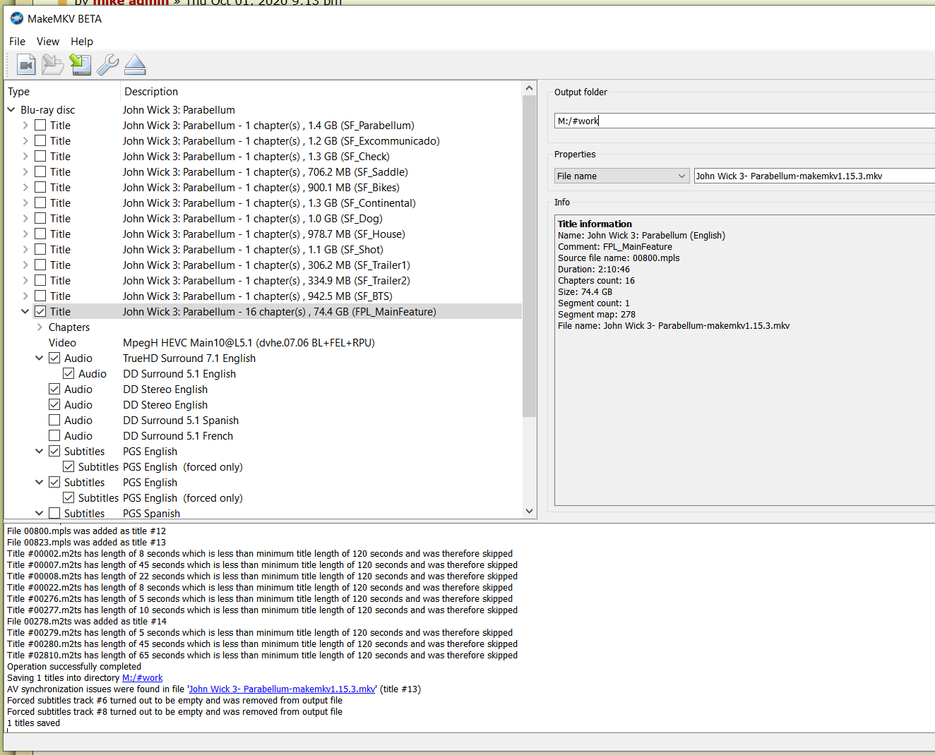

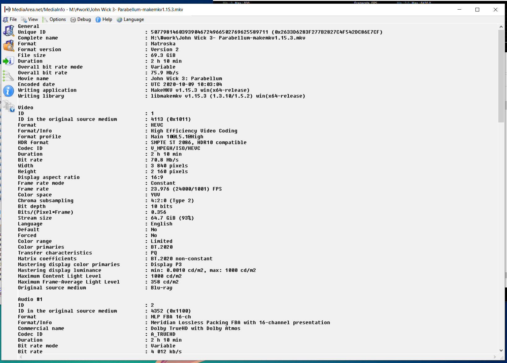

I've made a MKV using MakeMKV 1.15.3 using a source that has Dolby Vision. However, opening it in the latest MediaInfo 20.08 I don't see any reference to Dolby Vision in the video track HDR Format description. As far as I know, MediaInfo should support reading Dolby Vision data?

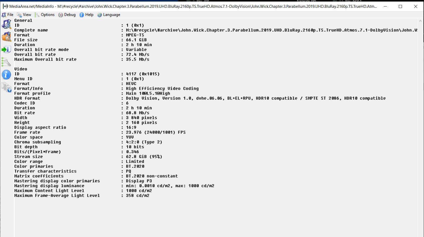

Muxing the Bluray m2ts to a TS file manually and reading it with MediaInfo, there is a clear reference to the Dolby Vision track.
Should MediaInfo be displaying the Dolby Vision info in MakeMKV mkv files? If not, how can I verify my MakeMKV created files contain DV without trying to play it on a Dolby Vision capable display?

I downloaded the latest version today and it is showing me the DV info for mkv files, I had to switch to Tree view to see this data.

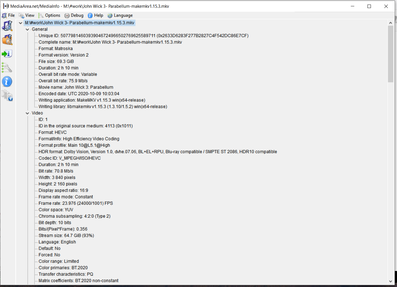

Can confirm, the new version of MediaInfo 20.09 (just released today Oct 9th) displays the DV info. When I checked last night with the previous version it didn't work.
