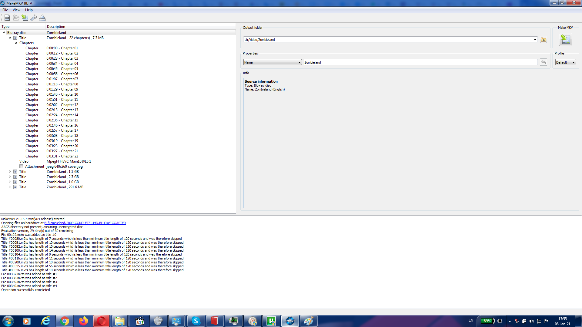

ultrasilent
Joined: Fri Jan 08, 2021 11:37 am
Re: Zombieland 4K UHD AACS 2.1
Post by ultrasilent »
TheCrazyCanuck wrote:
Fri Nov 27, 2020 5:09 am
lol when I saw this post pop back up to the top I was hoping this release was working. I still have my 1080p version ripped in case this one takes a while like Fury did :)
4k disk has been ripped 1 year 2 monthes ago.
I have another problem. Makemkv can`t see main movie when I am trying to make mkv from disk folder. Please see attachment.
