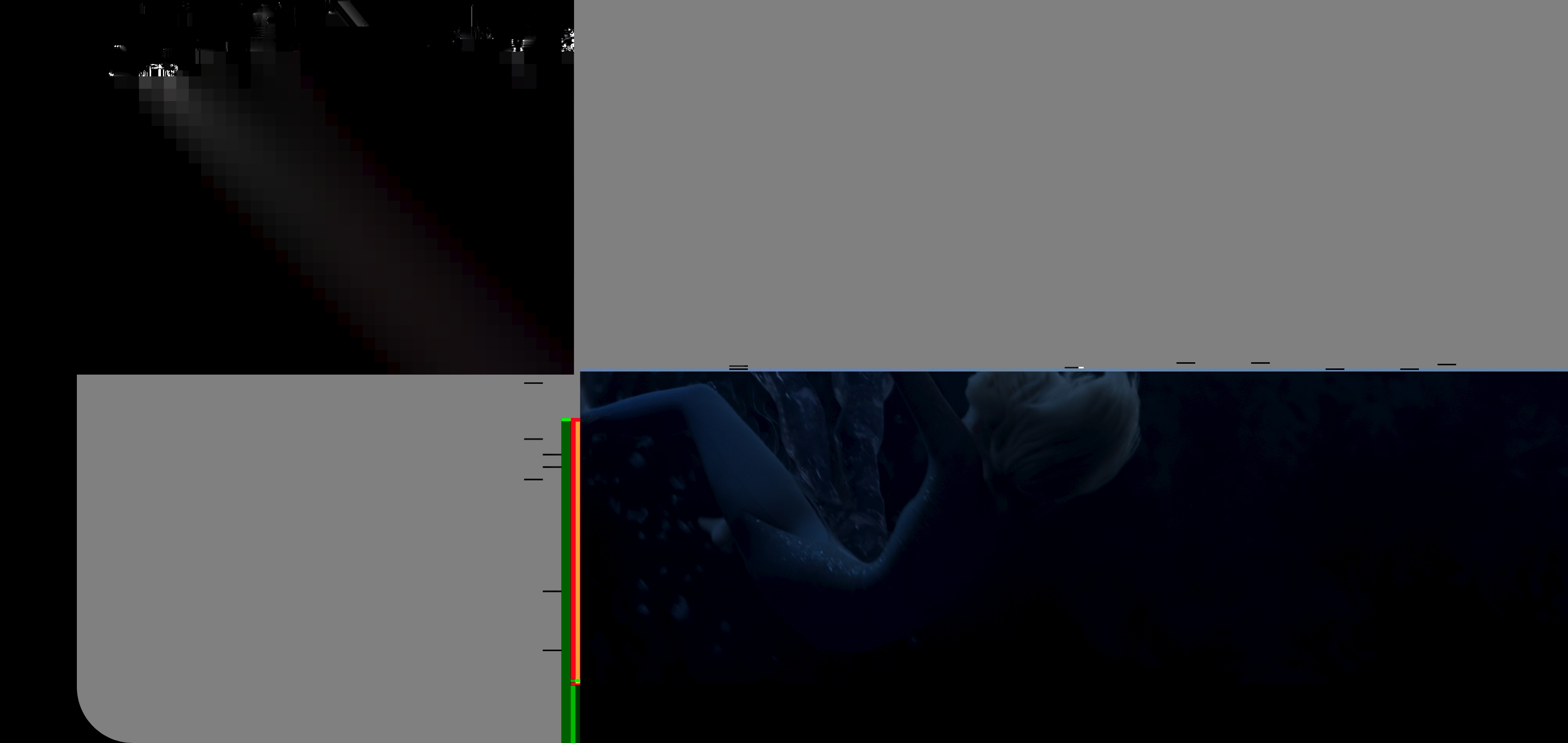

I've been having issues with the playback of the rip. Audio is on que, but the video is quartered on the screen. See attached. Weird stuff.
I'm using Plex on a Synology NAS. Other 4k UHD movies work fine.
- Screenshot_20200226-223458_Plex.jpg (390.56 KiB) Viewed 34392 times

I'm having the exact same issue. I've tried two different titles from the disk. 800 and 802 both with the result you've described. Interested to hear if anyone has come across a solution.ammiller wrote: Thu Feb 27, 2020 3:37 am I've been having issues with the playback of the rip. Audio is on que, but the video is quartered on the screen. See attached. Weird stuff.
