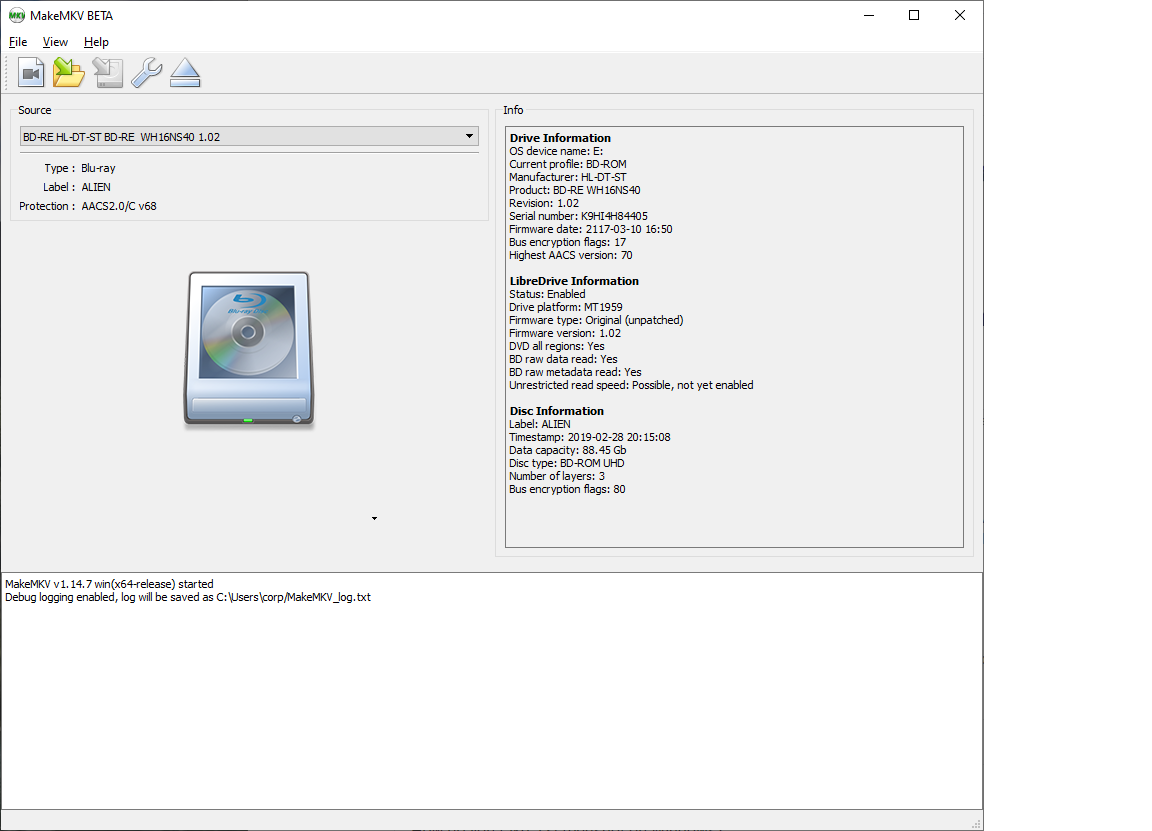

Alien 40th Anniversary problems -- disc or drive? (Update: apparently disc. Worked after cleaning with Novus.)
shallowturbot
Joined: Sat Oct 27, 2018 7:30 pm
Post by shallowturbot »
Consistent errors while trying to rip Alien 40th Anniversary. Have successfully ripped several other UHD discs with the same drive. Browsing other threads it's not clear to me whether this is more likely to be a problem with the disc itself or the drive/disc combination. To my untrained eye the errors in the log look more like drive/software issues being reported than just bits not arriving from the disc. All the same, I've gone through cleaning the disc and upping the number of retries, also trying the drive on different systems, all with the same result.
Different angle on the same question: has anyone successfully ripped the Alien 40th Anniversary UHD with a WH16NS40 on firmware 1.02 in an external enclosure?
Snapshot of MakeMKV window and logfile below.

DEBUG: Code 101000192 at ]8PztK'0td`)P05'q8:29394758
Error 'Scsi error - ILLEGAL REQUEST:INVALID FIELD IN CDB' occurred while reading '/BDMV/STREAM/00732.m2ts' at offset '0'
DEBUG: Code 0 at N.*jR!M0zLg3p,94*?XT:29397610
DEBUG: Code 0 at 0#09wVinY17cV#\_v,qo:213130145
DEBUG: Code 0 at 0#09wVinY17cV#\_v,qo:121262233
DEBUG: Code 0 at 0#09wVinY17cV#\_v,qo:29393286
DEBUG: Code 0 at Hx7Qmq@*:RO3=0Bl^(?f:29399680
DEBUG: Code 0 at *~hnCI|G[w/I^^d}:213130697
DEBUG: Code 0 at a\;2X|KY0-z5BQ^r{QzKS:213136332
DEBUG: Code 0 at *~hnCI|G[w/I^^d}:121262141
DEBUG: Code 0 at PT-QVWpr6F12!+sOW+:213137528
DEBUG: Code 0 at PT-QVWpr6F12!+sOW+:213138287
Failed to save title 33 to file F:/Video/ALIEN/ALIEN-FPL_MainFeature_UR_t33.mkv
0 titles saved, 2 failed
Last edited by shallowturbot on Sat Dec 28, 2019 10:04 pm, edited 1 time in total.
Procat
Posts: 43
Joined: Wed Mar 06, 2019 12:20 pm
Re: Alien 40th Anniversary problems -- disc or drive?
Post by Procat »
I have successfully ripped just the movie using the same drive. Sometimes you need to clean the disc multiple times, as some discs are very finicky.
shallowturbot
Thanks, and that seems to have been it. I cleaned with Novus #2 and #1 in succession, using first a microfiber then a lens cloth. I couldn't really tell any difference visually, but: disc ripped successfully.
