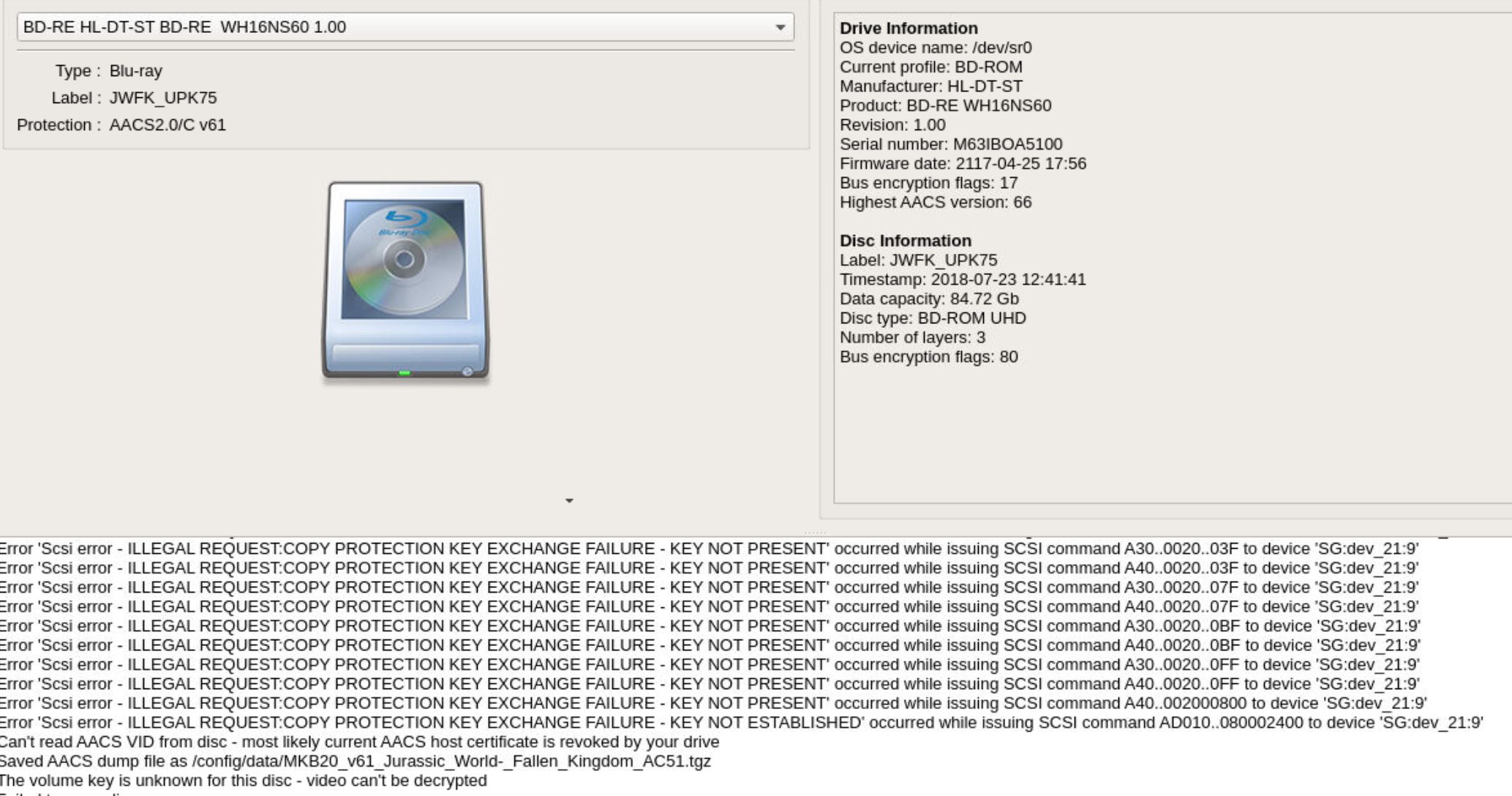

Received a LG drive flashed correctly and unable to rip any UHD disks, BR are fine. I am running the latest MAKEMKV in a Linux Docker Container, below is a screenshot. I have read the FAQs, reinstalled the container, and cleaned all the UHD disks w/no success. Any suggestions would be welcomed
Error new LG 1.00 UHD Drive

Did you send the AACS dump file to svq@makemkv.com ?

the problem here is makemkv is in the state before LibreDrive was added so it does not support WH16NS60 in this state it needs to get the update somehow or have a place to store it.
as i said i believe running the program nativity would fix the issue not in a container
ps.
maybe mike would know how to add it without internet probably just need privatedata.tar or something maybe this needs to be a separate download like hashed keys used to be so offline users could take advantage of the new ota update systems perks
ps.

I was able to address this issue by installing in another container for MakeMKV, no idea why the other container fails, will need to further investigation. In the interim the solution I have is working well and you are correct specific to LibreDrive....
