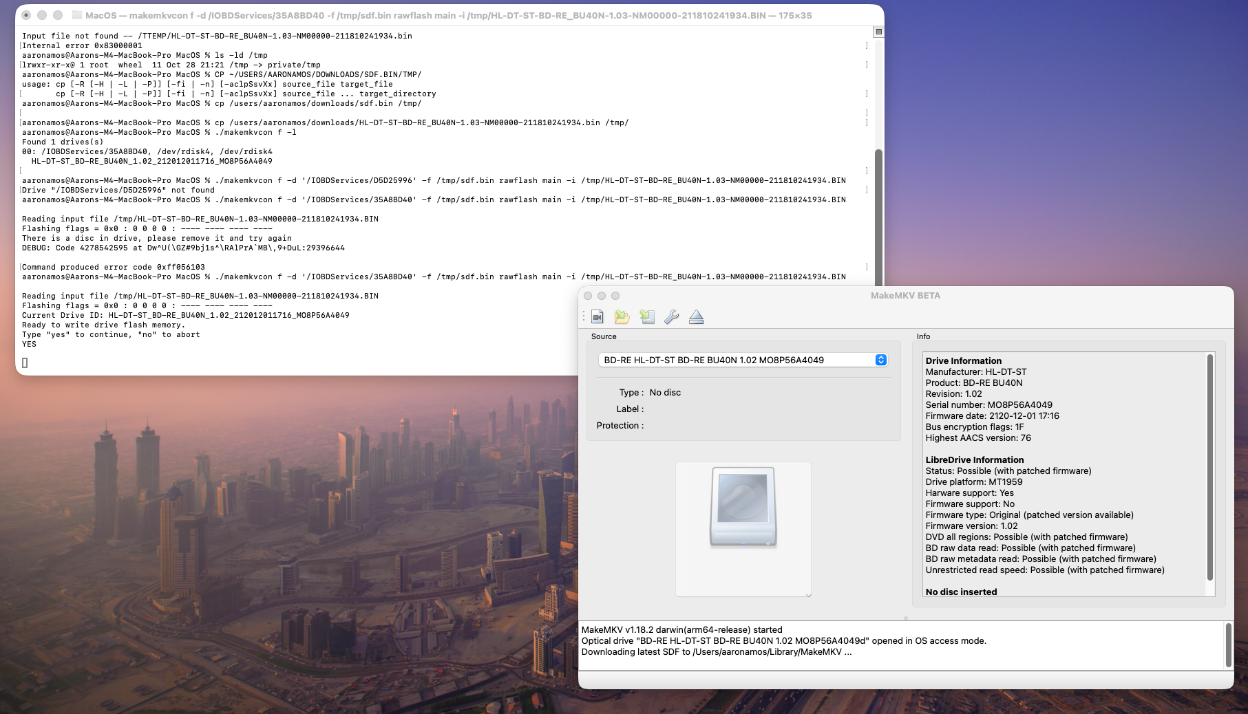

Hey all... this is my first time around in attempting to rip 4K Blu-ray's and I have purchased a verbatim 43888 for my 2024 MacBook Pro with macOS 26. I've done my best to follow all the instructions and will always essentially where I've landed and seems like it has stalled out. Any hints or chips that can be offered would be greatly appreciated.
Re: Struggling to open UHD discs on BU40N
The drive's firmware is probably encrypted. You need to switch 'rawflash main' to 'rawflash enc'.mocha1970 wrote: ↑Sun Nov 30, 2025 12:21 amHey all... this is my first time around in attempting to rip 4K Blu-ray's and I have purchased a verbatim 43888 for my 2024 MacBook Pro with macOS 26. I've done my best to follow all the instructions and will always essentially where I've landed and seems like it has stalled out. Any hints or chips that can be offered would be greatly appreciated.
For future reference, strictly speaking the files used in the command do not have to be in /tmp. They can be anywhere you like, you just have to adjust the command to point to where ever that file is. MacOS makes it easy to do this by allowing you to drag the file into the Terminal window which will insert at the cursor the fully qualified path to the file you drag into Terminal.
