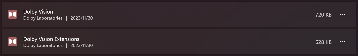

Dolby Vision raised black level in Movies & TV app.
Post by sw5163 »
I've been recently testing DV on the Win11 Movies & TV app. I got both "Dolby Vision" and "Dolby Vision Extensions" plugins installed since I don't know what's the difference between them.
I connected it to S95Z(S95C) and tried the CMv4.0 test pattern from quietvoid, most trims worked so I'm guessing it's LLDV (Samsung doesn't support DV). However, I noticed black level is raised and I got a dark grey when it should be completely black. Windows HDR Calibration app couldn't fix this. Any thoughts would be much appreciated thanks!
HDR10 content also has a very slight raised black in Movies & TV app but it's barely noticeable by naked eye, I have to take a 30 second exposure photo to really make sure and it can be fixed by the Windows HDR Calibration app. DV content black level is unacceptable compared to HDR10. Screenshot and SDR content look right, completely black.
Win11 is on 23H2, AMD driver 23.11.1, all softwares invovled are up to date.
GPU output is set to 10bit Full Range RGB HDR, TV input set to Full Range.
