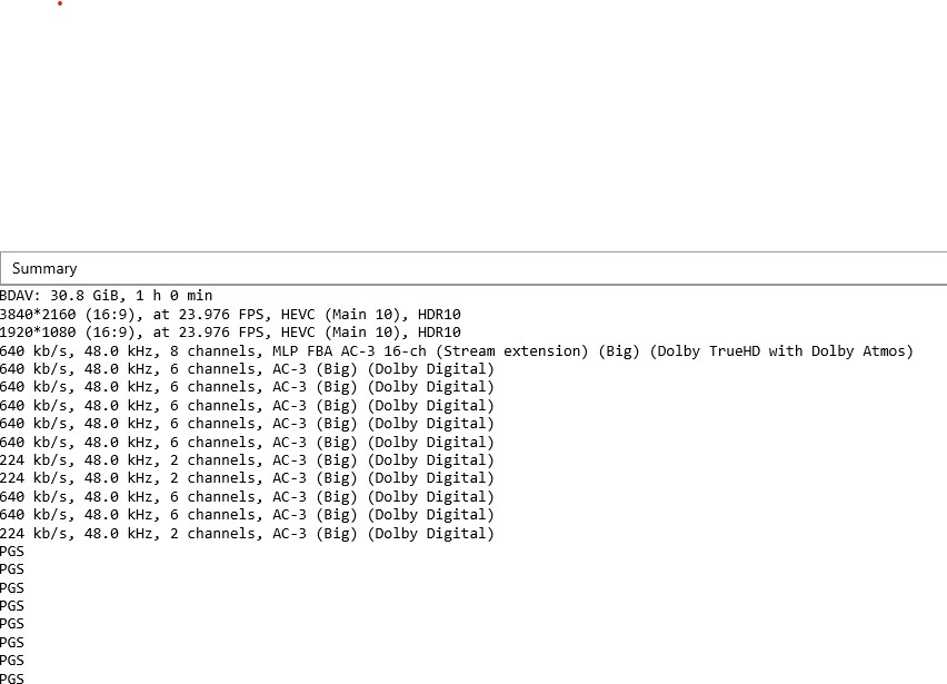

In the STREAM folder the main movie file is 00003.m2ts. VLC just hangs if I try to play that file. VLC will play other .m2ts files on the Top Gun disc, and will play the big movie .m2ts files on other backups. There is something odd about the Top Gun 00003.m2ts file that makemkv and vlc cannot handle, but apparently the Oppo can when it navigates there from the index.bdmv file.
mediainfo has trouble opening the 00003.m2ts file; takes it about 20 secs, then it reports: (image attached)

According to the screen shot of MediaInfo you posted, the file 00003.m2ts is 30.8 GiB and 1h 0m long. Which probably isn't right. Are you sure the rip/backup completed without error?
My UHD rip of Top Gun (1986) is about 50GB.
