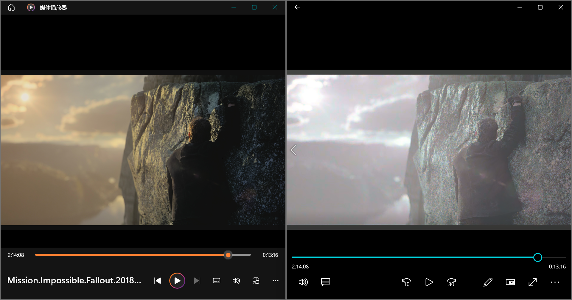

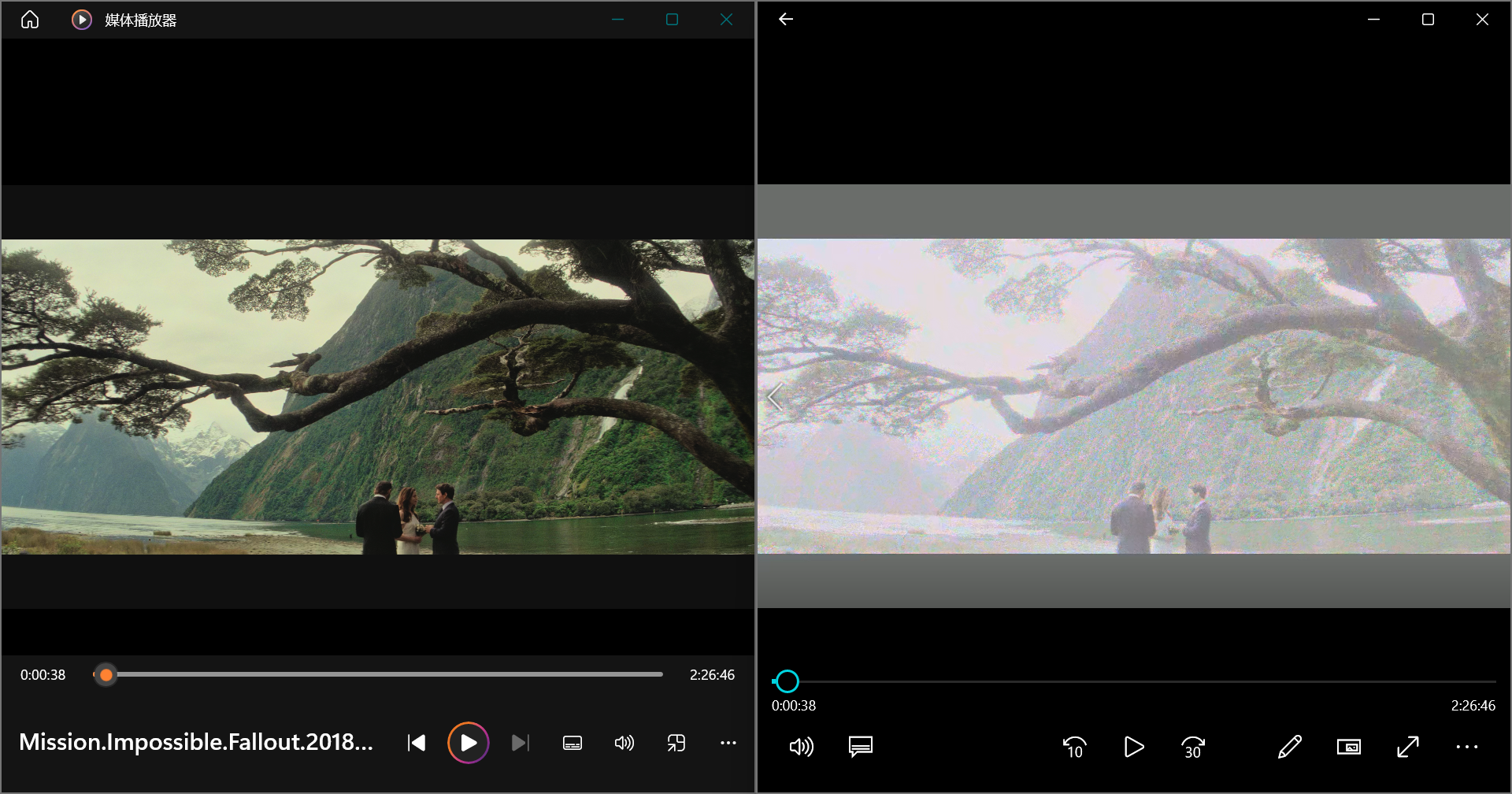

Manixx2020beyound wrote:
Wed Oct 05, 2022 5:35 pm
Got an off topic question for u guys,(should know this but never really checked myself)
If a fel is present in an imax enhanced disc
Does a 1080p fel adjust aspect ratio to reflect the bl, im not in front a pc but more than likely it does.
The only two movies im aware of that are IMAX and FEL are Mission.Impossible.Fallout.2018 and Aquaman.2018.
I have checked Fallout and the EL changes its aspect as BL.
left=BL, right=EL
