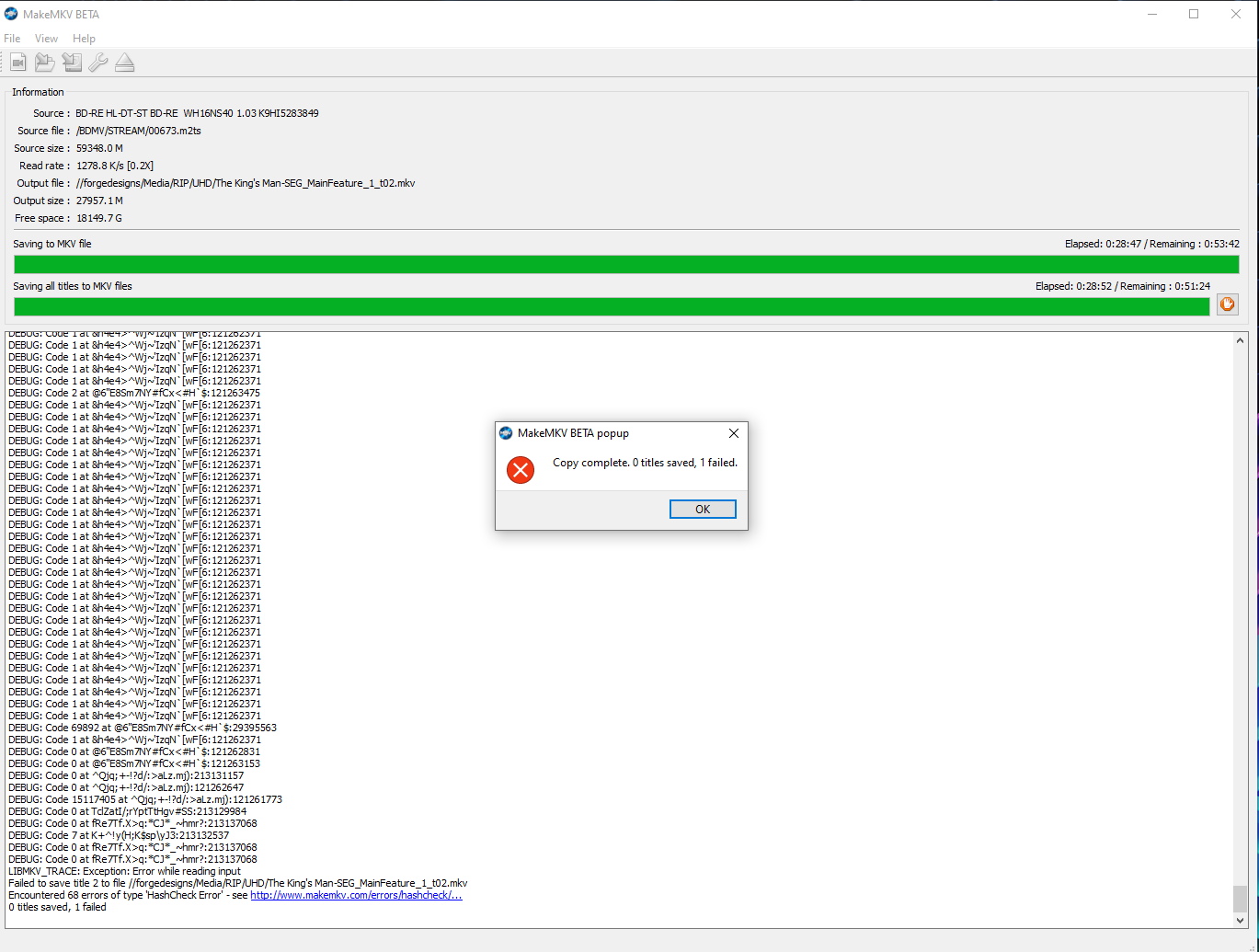

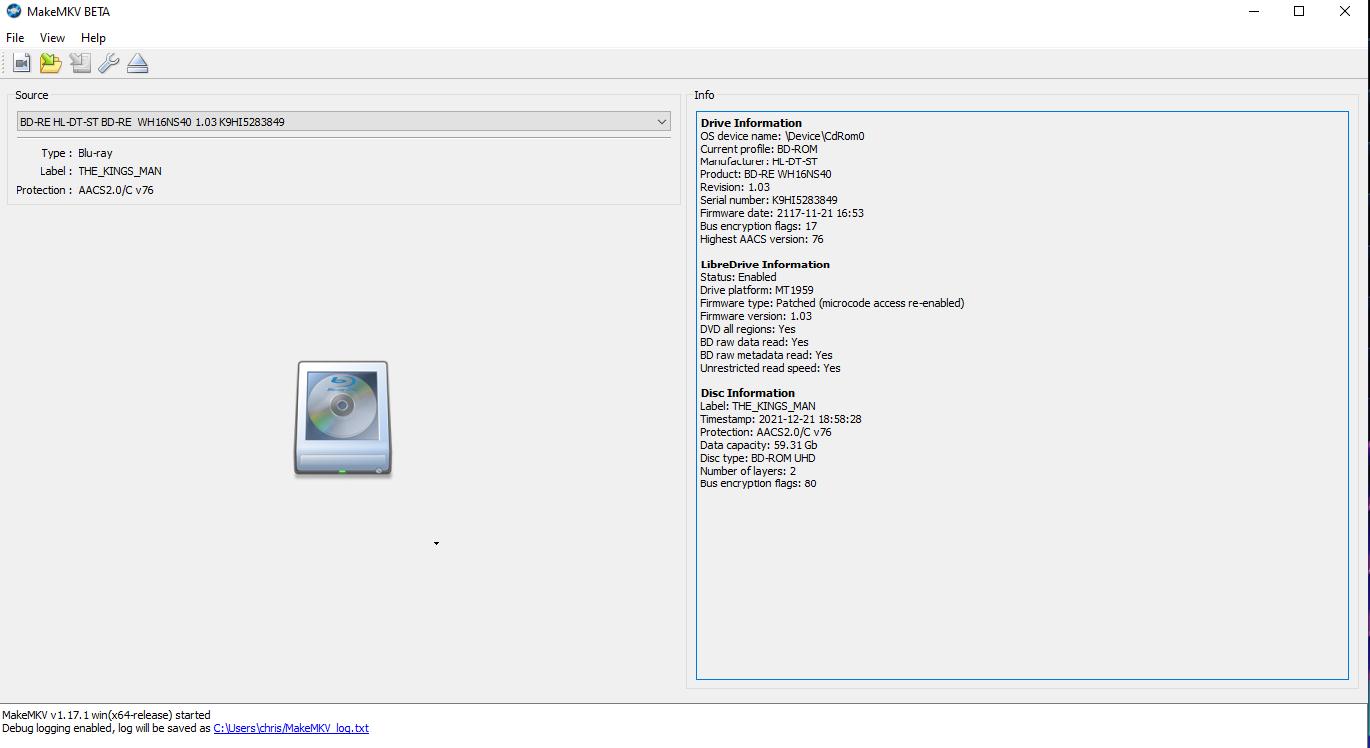

Been working on and off with Mike and his team via support@makemkv.com and svq@makemkv.com trying to solve a similar problem with The King's Man (2021) UHD disc that keeps failing. I've checked the 00673.m2ts and it appears to be playing okay via VLC, but every time I try to rip it with v1.17.0 or v1.17.1 I am getting the below errors.
I own the disc so if anyone has additional suggestions I am more than happy to try them. Additionally I have ripped 5-6 UHDs successfully since this log file so I know the drive is good and in working condition!
Thanks all!

This log was completed with the most up to date Hashed Keys downloaded...
(382.05 KiB) Downloaded 355 times

004004:0000 The source file '/BDMV/STREAM/00673.m2ts' is corrupt or invalid at offset 30038900736, attempting to work around
There are lots of messages like that in your log. Have you tried gently cleaning the disc?

@dcoke22 Great idea. I had a secondary UHD LG drive, but it died a year ago now, so probably time to pick up another. Thinking the ASUS BW-16D1HT is my next move!
Thanks for all the help and I'll post an update after I know more.

Gents, wanted to update you... Got a BU40N drive over the weekend, flashed in, installed in an enclosure fired it up with The freshly cleaned King's Man (2021) UHD disc and it STILL failed..... URGH!! Gotta love a good trial and error, but the good news is that I completely ruled out the drives, firmware and MakeMKV as it very much seems to be the mastering of the UHD itself. So ordered a Target version and will let you know how the saga plays out.
Thanks again!
