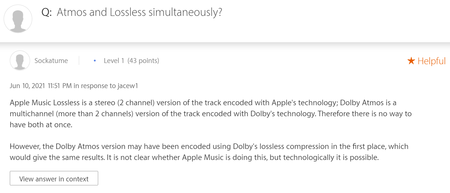

Never mind, it turns out Apple Music can only play 2 channel lossless or Atmos one at a time.
But, I would still be happy to know where I can download Apple atmos music, thx.
The attachment 屏幕截图 2022-07-18 003804.png is no longer available
I'll keep my opinion limitation for ATV is loseless 7.1 atmos.
If there is a public way to generate this "Dolby MAT PCM Atmos"
屏幕截图 2022-07-18 003804.png (86.25 KiB) Viewed 14286 times
