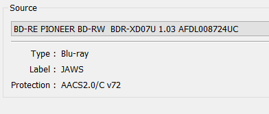

Newcomer to this forum... I am attempting to rip one of my 4K Ultra HD discs (Jaws) using MakeMKV and I am receiving errors when opening the disc with MakeMKV. I attached the log. Is this drive (Pioneer BDR-XD07UHD) incompatible for ripping 4K UHD with this encryption? If so, I will want to return the drive.

Yes, your drive is not "UHD-Friendly", it is "UHD Official". Pioneer drives do not currently have available a "rip-friendly" firmware.

Thanks folks for the info. I *think* the firmware is 1.03 ? It says 1.03 in that bitmap I attached, but I would have to check. How do you verify firmware version?

Re: Jaws 4K UHD with Pioneer BDR-XD07UHD
I found this ... From MakeMKV when opening Pioneer BDR-XD07UHD.
This may show needed info.

Ok thanks for info so they definitely have been updated the firmware the developer got my firmware from.1.01 hopefully it also works on 1.03kbf100 wrote: ↑Mon Jan 10, 2022 5:51 pmI found this ... From MakeMKV when opening Pioneer BDR-XD07UHD.
