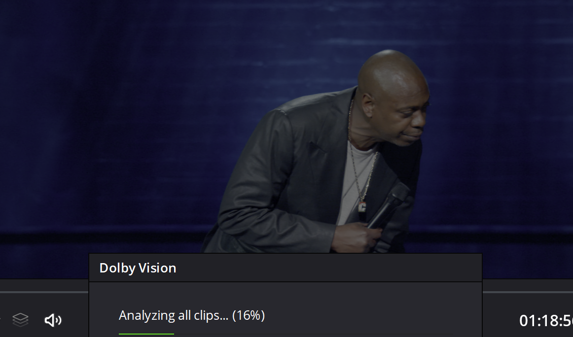

To me, it looks like madVR is including the black bars in the measurement because all the min L1 values are 0 in your DV sample. Could be just a different scene cut though.
If I don't set the correct blanking in resolve, I also get 0 everywhere. If set correctly, then I get my first min 0 at exactly 14sec ( frame 343)
otherwise, the max and avg numbers are pretty close. I did not check for a visual difference, only checked the metadata.
I generated metadata using Davinci Resolve Dolby Vision algorithm(same algo studios use). Here's how the L1 metadata compares to madVR for this Netflix clip.
madvr rpu frame 1:

resolve rpu frame 1:
        "Level1": {
          "block_info": {

chros

RESET_9999 wrote:
Mon Oct 11, 2021 3:39 pm
It's Amazon hdr10+. Thanks for the test, measurement results are pretty close indeed (apart from the first avg value, where it's double), really interesting:
- Resolve L6 maxCLL is set to 1680, but it measure more than 3000 nits? what's the unit of the values on the image, nits or PQ?
- - interestingly that's the measurement summary from madvr: MaxCLL 100%: 1680, 99.9%: 1545, MaxFALL: 58, AvgFALL: 9, AvgFMLL: 524 nits
- Resolve set some L2 trim properties (that obviously dovi_tool doesn't by default), why is that? Did you set it or is it automatic?
- Resolve has 3 blocks of L2 metadata, why is that? (target_max_pq: 2081, 2851, 3079; dovi_tool has just 1: 3079) Which one is used during playback?
Thanks, my question is what the effect of min_pq value is in reality.
@quietvoid, can we overwrite an L2 value in RPU easily, if so how? (e.g. min_pq to 12) Or we have to export it into json and manually replace them and then reinjecting it?

Posts: 2392
chros wrote:
Tue Oct 12, 2021 9:43 am
I don't really know but Dolby clearly says that min 0 for all the scenes is incorrect.
When I get home, I'll do the analysis with the HDR10plus algorithm and see if I get a different min pq for that clip.
1- Resolve L6 maxCLL is set to 1680, but it measure more than 3000 nits? what's the unit of the values on the image, nits or PQ?
2- Resolve set some L2 trim properties (that obviously dovi_tool doesn't by default), why is that? Did you set it or is it automatic?
3- Resolve has 3 blocks of L2 metadata, why is that? (target_max_pq: 2081, 2851, 3079; dovi_tool has just 1: 3079) Which one is used during playback?
1- the L6 metadata is edited manually, I just took the numbers from your post: viewtopic.php?p=113519#p113519
2- this is the resolve default trim passes adjustments for each target display. You need a license to modify them in resolve but everything else is available and free to use.
3- As Quietvoid said.
