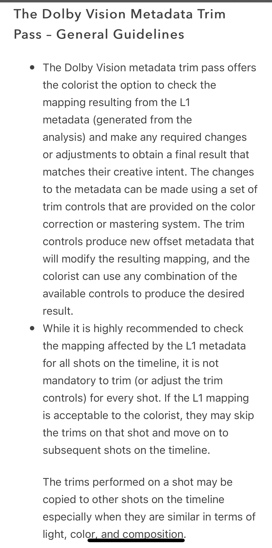

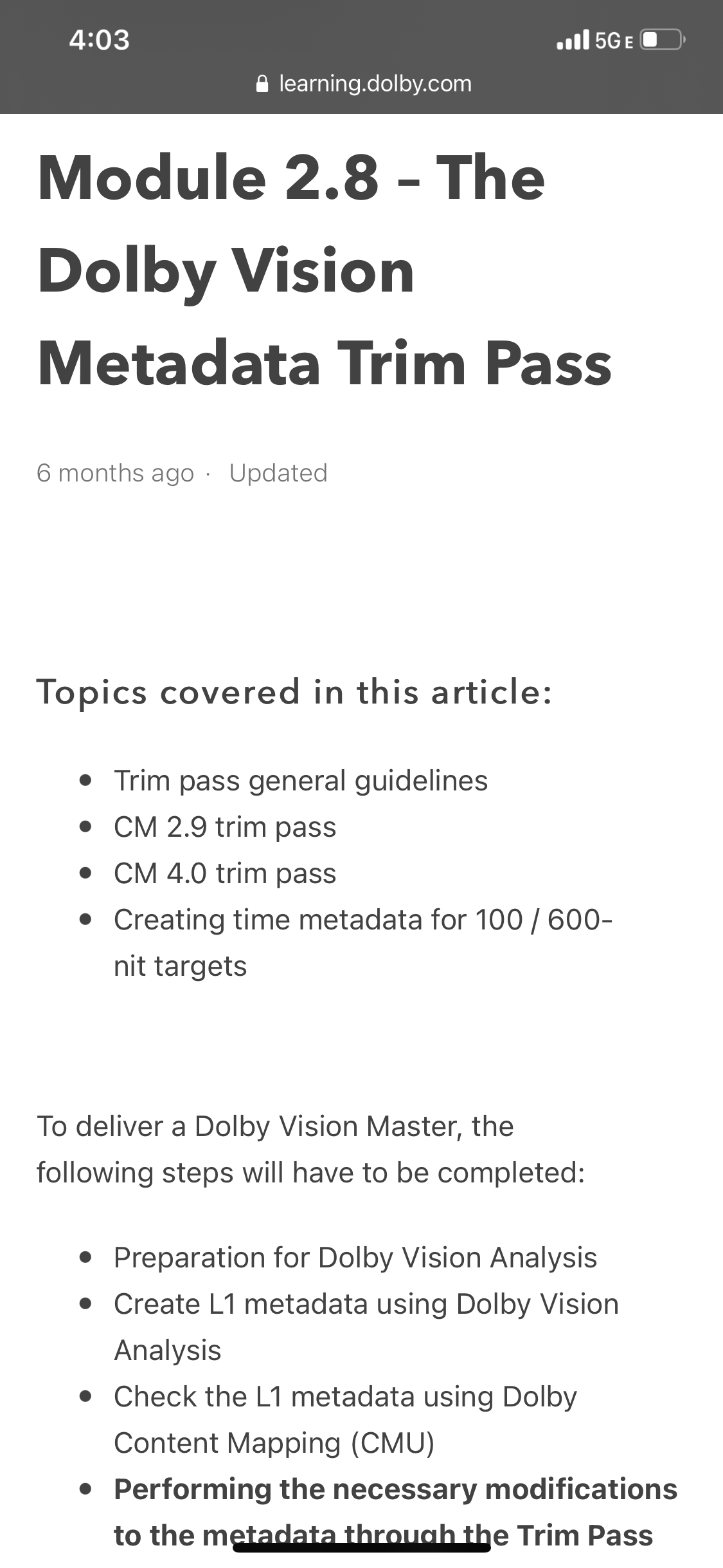

Nice finding, again! But what is a trim pass in DoVi world and what is it used for? (I saw it in the RPU as well.)

Trim pass process.
https://learning.dolby.com/hc/en-us/art ... Trim-Pass-
