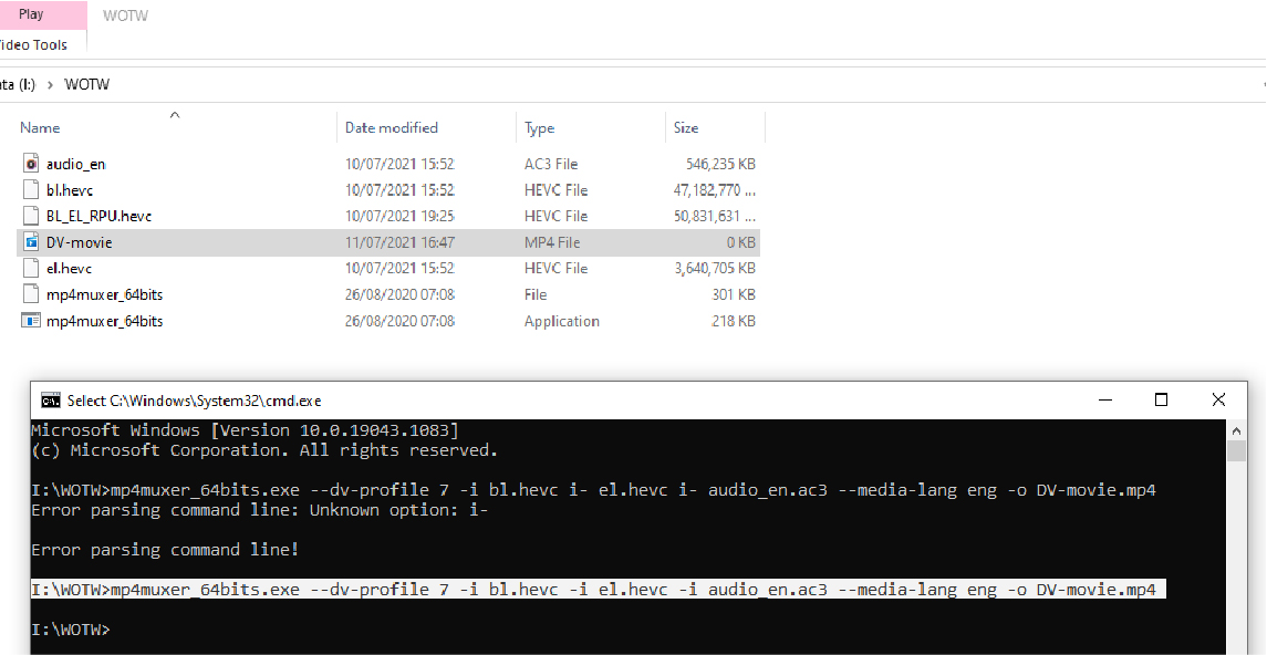

This is my first post, I´ve been following this topic from time ago, but this weekend I finally started to put hand on building playable DV files on my LG B7.
I tried to find an answer to my problem all along the topic, but no luck.
Everytime I used mp4muxer (any version) I get an empty (0kb) file, and I cant figured out what Im doing wrong.
In image you can see the files Im trying to use (BL, El and ac3) and the command line
what Im doing wrong?
thanks!
Walter

- Image_Issue
- mp4_0kb_file.jpg (263.08 KiB) Viewed 19065 times

The reason you have a 0kb file is You need to wait for it to finish, it can look like nothing is happening but depending on the speed of your system plus the size of your file it could be 20 - 40 mins before the file finishes outputting.

Thanks for your comment.DaMacFunkin wrote: ↑Mon Jul 12, 2021 4:44 amThe reason you have a 0kb file is You need to wait for it to finish, it can look like nothing is happening but depending on the speed of your system plus the size of your file it could be 20 - 40 mins before the file finishes outputting.
wait for 1hs and still 0kb. Tested using differents disks and the same 0kb output.
After writing the command line, as soon as I press enter, the output file is created and in cmd its appear the line referring to a disk/folder (in my case H:\DV Test>)
but nothing happens, should I see some command/instruction like "%counting" or something denoting mp4muxer is working?
i think the battle lost against DV-MKV remux? (dual-layer)
