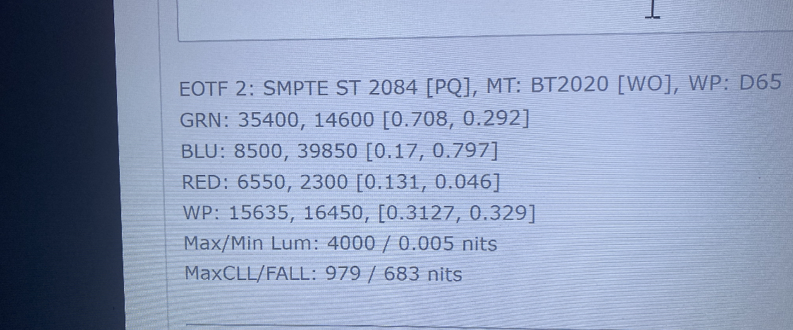

jedd_ai wrote:
Wed Mar 17, 2021 11:29 pm
In Kodi it should be Settings->Player-> Adjust display refresh rate = Always
How did you enable Amlogic on-screen debug output? Do you have their tool?
thank you
i get the osd by connecting my hdfury vertex in the chain.

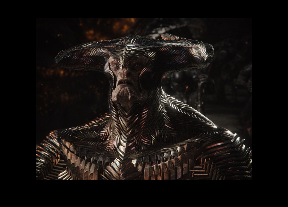

Ok after a pretty good review of the ugoos so far, ordering mines today, just to have as a backup for the Sony x700fel playback.
Did u guys see Snyder Z, if u have 4hours to spare great remake
But dam all that millions spent twice on the same movie but it is well done this time
Are we really soposed to watch this movie with black bars on the side??

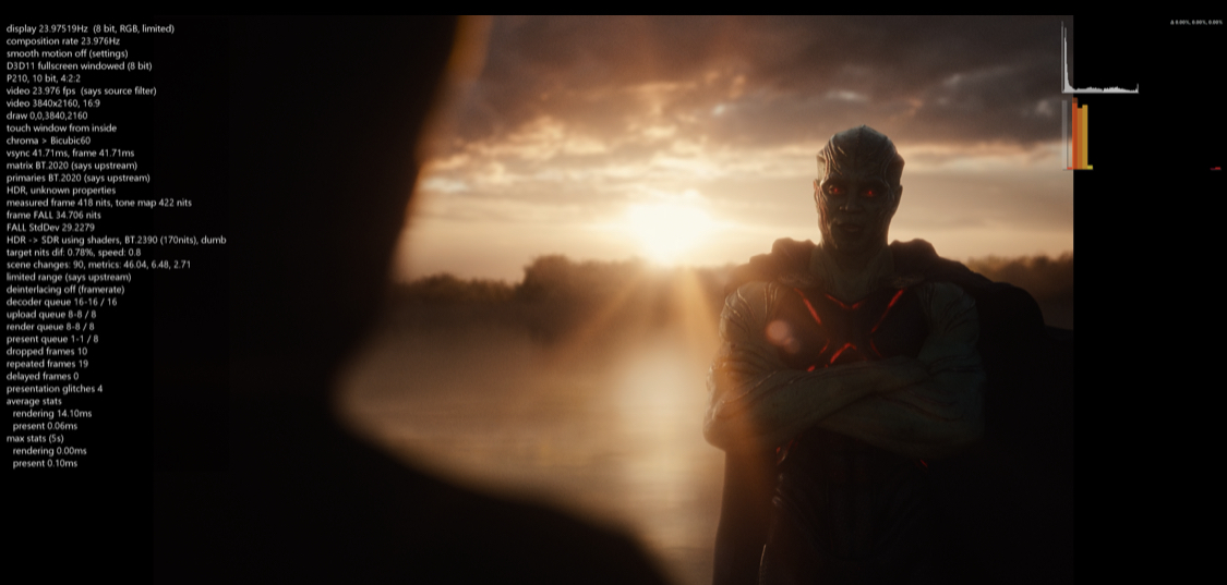

Manixx2020beyound wrote:
Thu Mar 18, 2021 12:24 pm
damn 4:3 :(
and they graded it darker ...
justice league original:
Mastering display luminance : min: 0.0050 cd/m2, max: 4000 cd/m2
Maximum Content Light Level : 1016 cd/m2
Maximum Frame-Average Light Level : 342 cd/m2
justice league snyder version:
Mastering display luminance : min: 0.0001 cd/m2, max: 1000 cd/m2
Maximum Content Light Level : 597 cd/m2
Maximum Frame-Average Light Level : 122 cd/m2
