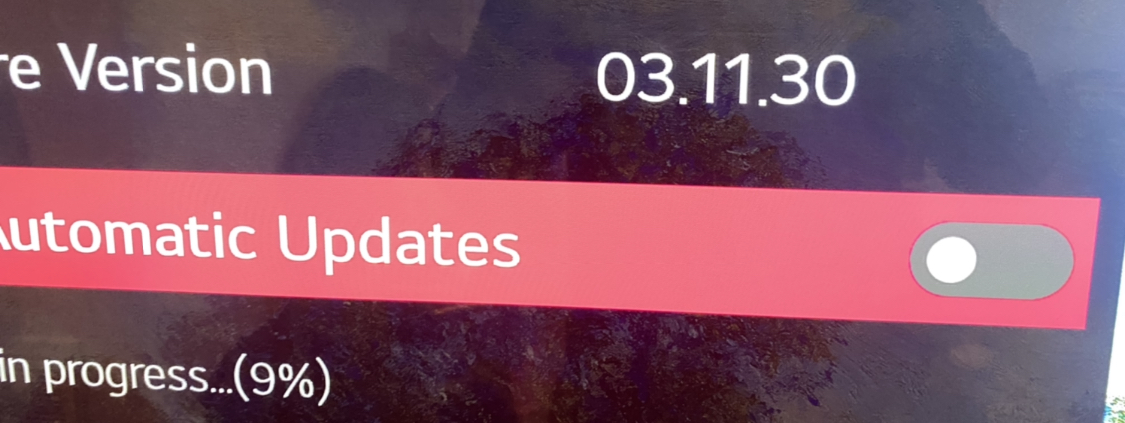

Manixx2020beyound wrote:
Sun Jan 17, 2021 6:18 pm
CX plays fel fine in usb mp4 dl dv.
Firmware#
Tlc 6 series plays dv fel as well usb.
CX did not play DV (DTDL) mp4 prior to lastest firmware.
They do play NOW but as @Agneva pointed out, FEL files on CX look bad, too dark, as if EL was ignored alltogether.
That would explain the lack of support at launch.

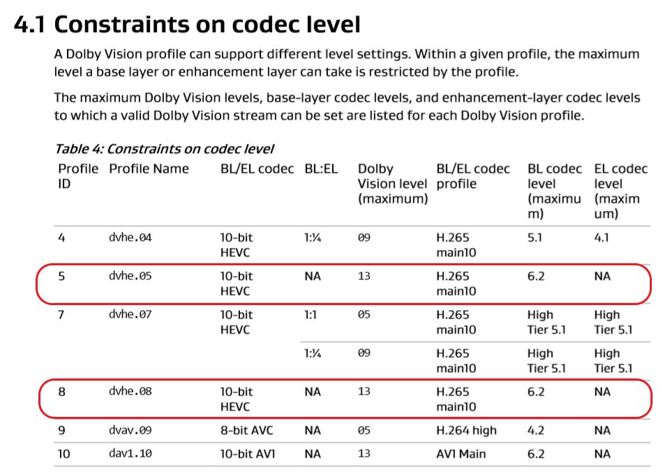

DaMacFunkin wrote:
Mon Jan 18, 2021 7:52 am
The CX can do TV led Dolby Vision so it has 2 decoders, so no discussion.
What is more likely is the second decoder is crippled in firmware for media file playback.
Have you tried built in Plex app from NAS?
You confuse metadata decoder with 2. full-fledged HEVC decoder :!: (which restores the original from FEL with 12bit)
For Netflix Dolby Vision is only DV Profil 5 / 8 necessary, without 2. HEVC stream / FEL:
DV layers Matrix explained.jpg (89.39 KiB) Viewed 26630 times
Post by shawnc22 »
Being able to do TV-led DV has nothing to do with whether it has 2 HEVC decoders or not. If that's the case, then every DV capable TV that's not a Sony should be able to play DL FEL mp4s. The decoding step (1 HEVC or 2 HEVC decoders needed to reconstruct the original picture) occurs prior to the tone mapping step (TV-led or player-led).

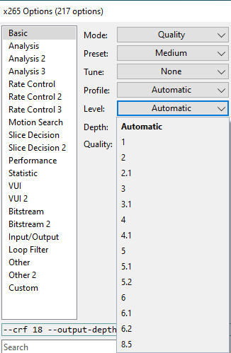

that's not the point here, but it doesn't matter.
Resolution : [3840×2160]
Video Bitrate : [15,3 MB/s]
FPS: : [23,976]
Audio Language : [German (DTS-HD MA 5.1/EAC3 5.1) / English (EAC3 5.1)]
Subtitle Lang. : [German (Complete/Complete SDH) / English (Complete SDH)]
Encoding : [StaxRip -> HEVC x265 Main10 High@L5.1 CRF16 (UHD Ready)]
Colorgrading : [DaVinci Resolve Studio 16 -> BT2020 HDR10 @1000 Nits]
Source : [Mandalorian.S02E01.Chapter.09.REPACK.2160p.WEB-DL.DDP5.1.HDR.x265-RONIN]
x265 is always reencoded, no professional provider encodes with x265 :!:
