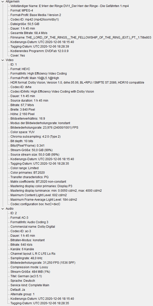

How can I check if the remux has dv?

@hansooloo I created:
DV SL and played it on the LG CX media player.
LotR has an empty EL (called MEL), so no need to create a DL Stream.
Can you maybe describe the steps you took to make this profile 5 variant? What tools did you use? Thanks!

Post by agneva »
Just the ape :lol:

Hi - I took this advice, and bought an Nvidia Shield, enabled DV on it, and played my DV extracted MKV using the shield Plex app, and am still only getting HDR playback - any ideas? The metadata for the MKV file has DV listed as “true.”
