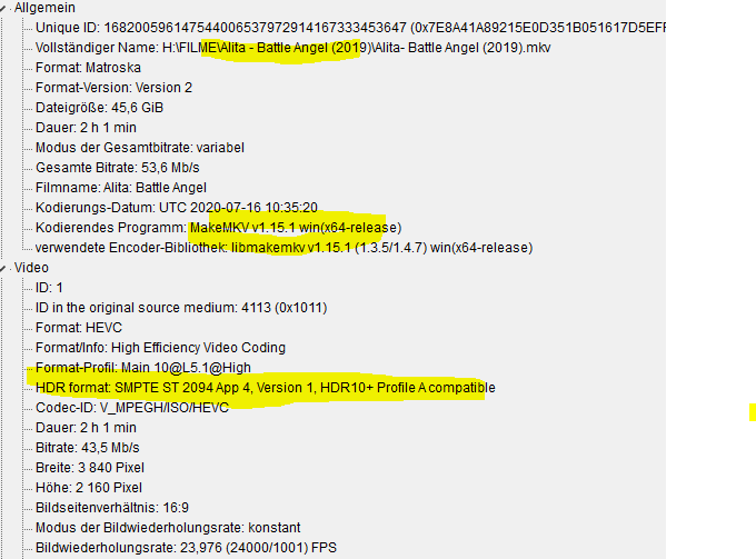

Hey guys,
i didnt spent attention to the DV thing but now that Plexbeta is able to stream DV i checked my older Rips..
Aquaman was ripped to early - but my Alita - Battle Angle should have DV right?!
- Bild_2020-11-19_175414.png (36.77 KiB) Viewed 34247 times

That will have the non-standard DV in MKV format Mike initially used in MakeMKV 1.15.1. You want to use at least 1.15.2 which then used the agreed standard approach.

ok - then all my future rips will be fine - thank you!

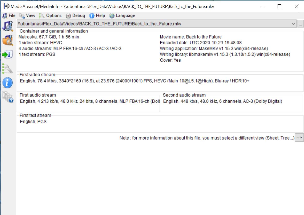

First thanks for the thread. I've never really paid attention to HDR or Dolby Vision as my TV did not support it (early 4k LG). However, I do have a new set due today that does so have been busy reading through this.
All of my physical media has been backed up using makemkv. Based on what I have read through the first few pages the latest version of makemkv will automatically provide the dolby information. For earlier movies I extracted I need to redo using the latest. Correct?
I thought I used 1.15.3 for Back to the Future but my mediainfo returns something different. Could be the version Ubuntu uses (19.x) or I'm doing something wrong (probably) or I am not sure what I'm looking at. In any case I'm going back through my physical media, seeing what is dolby vision, and getting ready to extract again with 1.15.3.
Example of Back to the Future disk (I thought was dolby vision):
HDR format : SMPTE ST 2094 App 4
HDR format : SMPTE ST 2094 App 4, Version 1, HDR10+ Profile B compatible
HDR_Format_Commercial : HDR10+
HDR_Format_Version : 1
HDR_Format_Compatibility : HDR10+ Profile B
Internet media type : video/H265
Codec ID : V_MPEGH/ISO/HEVC

You need MediaInfo 20.09 to see the Dolby Vision information from MKV files made by MakeMKV, so that is your issue.

Thanks. I thought that might be it but wasn't sure.
I only have 17 movies it looks like that have dolby vision support so not too bad but if I can save 12 - 17 hours of work that is always great
Let me see why my Ubuntu didn't update or pull the latest version of mediainfo so I can check.
Thanks again, have a great day!
Edit 1: Ok, made it further through the thread and saw a few pages back that it was suggested if makemkv video shows (BL+FEL+RPU) then it should show up as dolby vision, good to go. That is what I see when I reopen the back to the future disk under the one title.
Edit 2: more homework. I couldn't update the Ubuntu version of mediainfo for some reason so I downloaded version 20.x on my windows PC and looked at Back to the Future disc. I'm going to test another copy to see what it shows.

Ha, I found it. Love this forum.
Just did a search after reading through this thread and on the Windows version it was suggested to use the 'tree' view. There it is now
