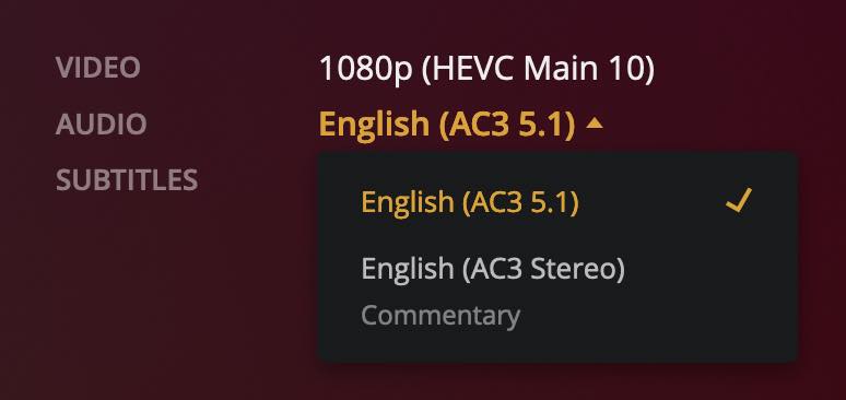

Getting the movie into a single .mkv file is easier, IMHO, than dealing with .m2ts files. .mkv files support chapters and they let you get rid of language & subtitle tracks you don't want or need. You can also name the tracks so you can tell which one is a commentary track. And you can set the forced subtitle tracks as forced and default, so Plex will play them by default.
