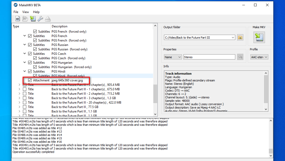

Noticed one mistake. If you have set a stereo profile, the attachment is not saved. How to fix it?
