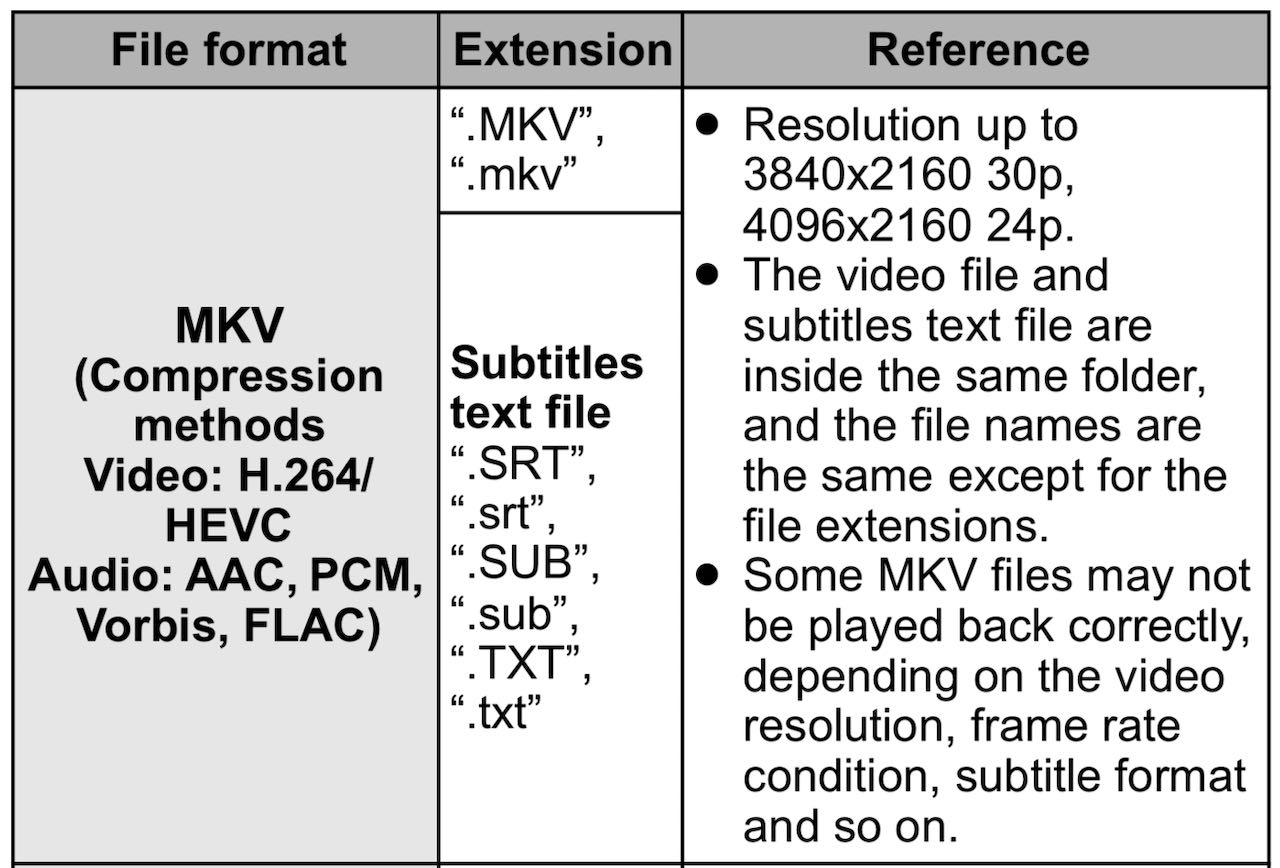

I own many 4k movie discs. I have never owned a 4K UHD player. My old blu-ray player hasn't been powered on in more than a year. That's a long winded way to say, I have no idea how the Panasonic works, having never used it.
https://help.panasonic.ca/viewing/ALL/D ... BS0258.pdf
The manual for it is online. On page 42 in the specifications is says:
That sure seems like you could put a .srt in the same folder as your .mkv.
Yes, of course, I've read the manual.
And tried with a 2160p MKV with a very long file name (didn't work) - I tried with something with less characters in the filename and it has worked. Weirdly enough. I will surely investigate this more.
