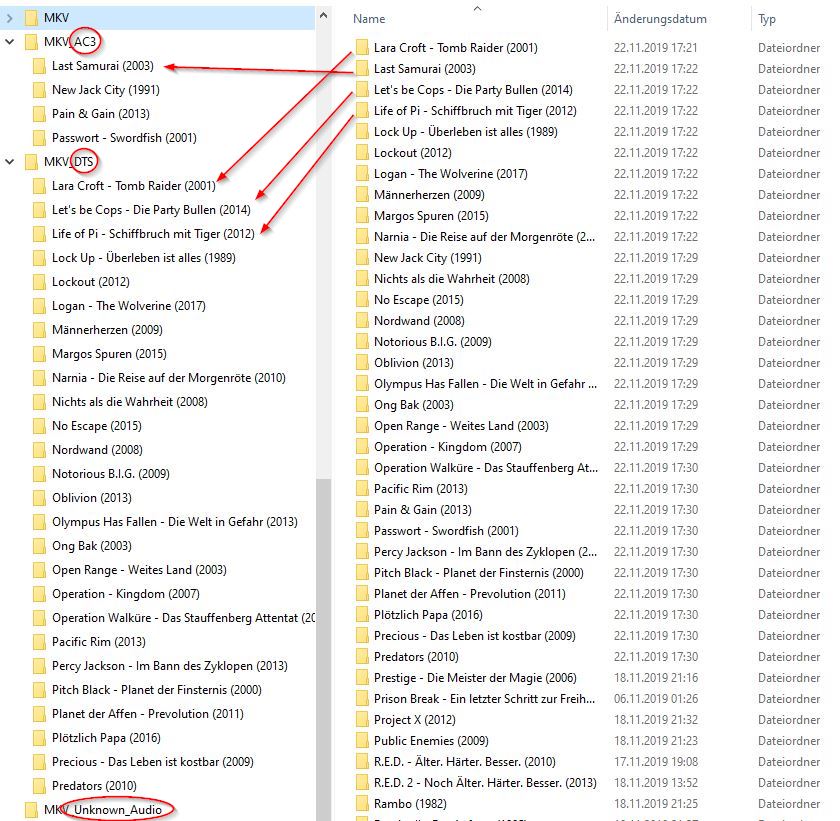

This is how it looks after several MKVs have been sorted:
2019-11-22 17_32_28.jpg (153.66 KiB) Viewed 16524 times
The source folder and the cover.jpg is left untouched:

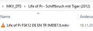

And the MKV has been moved to the the target "DTS" folder:
2019-11-22 17_46_30.jpg (7.27 KiB) Viewed 16524 times

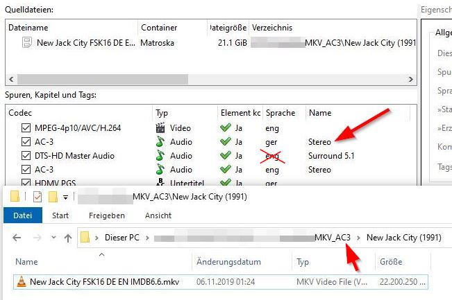

As you can see this MKV is moved to the "AC3" folder as the best German audio track is "AC3 Stereo":
2019-11-22 17_57_23.jpg (53.22 KiB) Viewed 16511 times

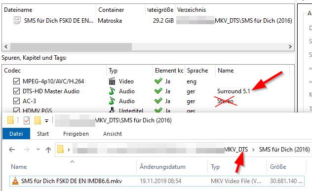

Instead, this MKV has been moved to "DTS" as the German "AC3 Stereo" track has less channels than the 5.1 DTS track (and finally is an AC3 stereo track that follows a 5.1 track in 99% of all cases a "Director's Comment"):
2019-11-22 18_18_40.jpg (46.18 KiB) Viewed 16518 times

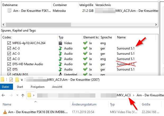

And finally this MKV has been moved to "AC3" even tough it contains an DTS track with more channels (6-channels are all I need - feel free to change the script to fit your needs):
2019-11-22 18_37_40.jpg (49.59 KiB) Viewed 16514 times
