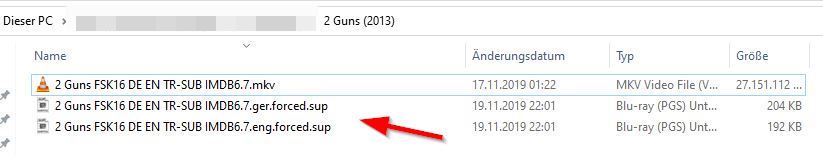

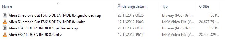

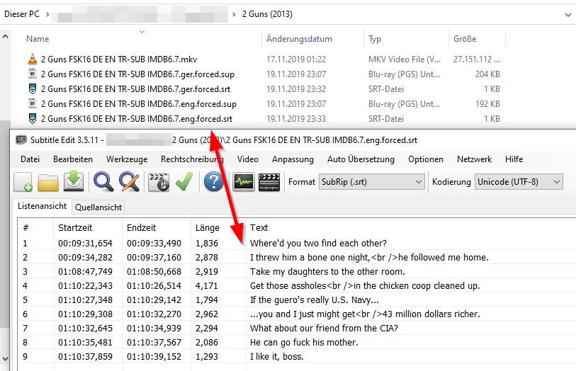

I finished this "little" bash script to automatically export all subtitles of all MKVs and determine the forced subtitles of them. Forced subtitles are determined by their filesize (<3MB works for 99% of my Blu-Ray rips) or if the subtitle track name already has the track name "Forced". For example if you have named them through MakeMKV:
2019-11-19 22_43_17.jpg (48.49 KiB) Viewed 29208 times
Everytime the script is executed it processes the next MKV file. So you need to restart it by cronjob or task schedulers. You can copy & paste this script directly into the command line as well.

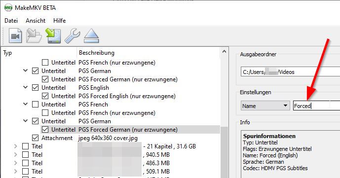

P.S. Please vote for auto-naming of forced subtitles.

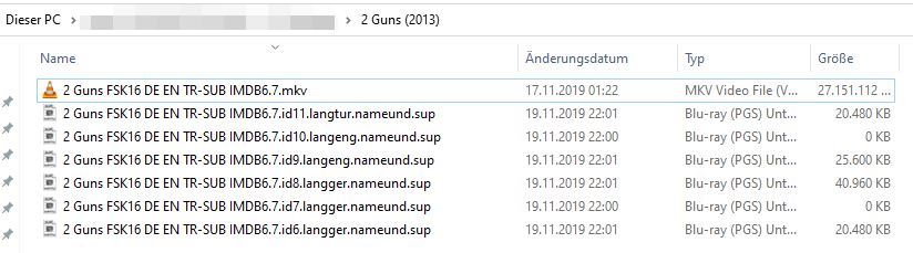

mkv2sup exports all subtitles:
2019-11-19 22_01_30.jpg (43.86 KiB) Viewed 29207 times

Finally you can drag & drop the SUP files into Subtitle Edit and convert them to SRT:
2019-11-19 23_33_13.jpg (97.14 KiB) Viewed 29207 times
The SUP file naming is based on Plex:
https://support.plex.tv/articles/200471 ... dia/#toc-3
Movies/Movie_Name (Release Date).[Language_Code].forced.ext
mgutt

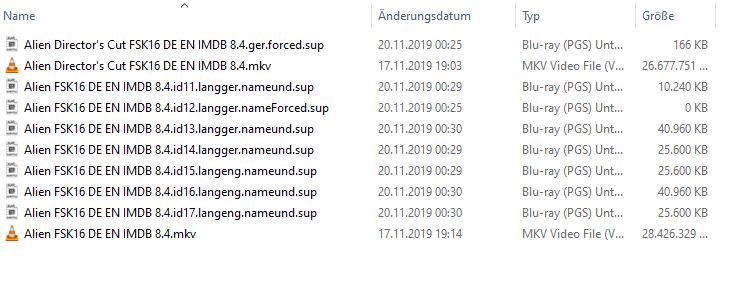

Multiple MKVs per movie are supported as well:
While exporting all subtitles:
2019-11-20 00_30_26.jpg (49.16 KiB) Viewed 29194 times
Result:
2019-11-20 00_32_49.jpg (20.59 KiB) Viewed 29194 times
