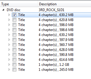

OK, here is the problem and the solution.
The problem is if NAME and COMMENT are empty for each track then the current setting is to default to Title. That doesn't work for discs with multiple Episodes. You just get Title_t00.mkv, Title_t01.mkv and so on. No way to identify what disc the title is from.
There are two solutions. The first solution is to create a directory using the Disk Name and then store all of the Title_t**.mkv files there. That way when you are ripping multiple episode disks each one has their own directory.
The second solution is if there are not names for each track you can default to the Disc name. Instead of {title:+DFLT} there could be another preset variable called DISCNAME that contains the name of the inserted disk. You could then use {DISCNAME:+DFLT}. If the NAME variable is empty it would default to the Disc Name of the inserted disk. In the example below the inserted Disc only Shows Title for everything as there isn't a name for each track. If you add a DISCNAME variable then the '3RD_ROCK_S1D1' would be used instead of Title for each track. When the tracks are extracted they would show as 3RD_ROCK_S1D1_t00.mkv, 3RD_ROCK_S1D1_t01.mkv.
Either of the suggested solution would be great.
